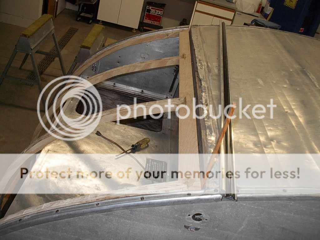

After removing the aluminum skin, I began dissecting the wood interior structure of the galley lid. It consists of 4, doubled 3/4" plywood ribs, with a 3/4" plywood
baseboard at the bottom, all skinned on both sides with 1/8" plywood. It appears to be lauan on the outside, and might be birch on the interior, although it is so
far deteriorated, it 's hard to tell. The ribs are also strengthened by small gussets at the base.

After dissecting the old wooden shell, I cut 8-3/4" ribs and a new baseboard to replicate "The Kings" original construction technique. Last photo shows dry-fit
of new ribs. Next session will be to shape a new oak board at the hinge end, trim the ribs, and glue and screw the whole thing together.

Here's the "clone" of the original galley lid skeleton, the top piece will be trimmed and attached upon the arrival of Grant's hinge. (It's one of the very few
deviations from original that will go into this trailer.)

Well, the "better than hurricane" hinge from Grant showed up today, so I was able to accurately measure, and cut the ribs to length and glue/screw the
final piece of the skeleton in place.
Then, a final dry-fit, before trimming the hinge halves to fit.
