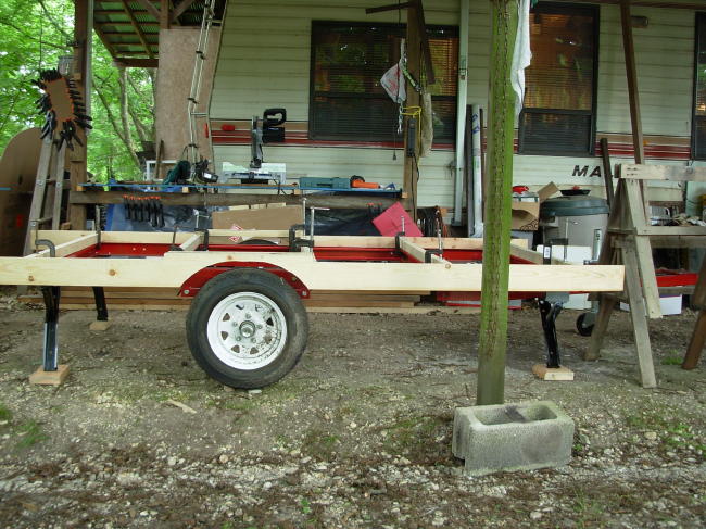

Postby Nobody » Wed Apr 10, 2013 10:16 am
I installed the BAL type stabilizers on all 4 corners of my HF 1740# trailer before ever beginning the cabin build. We've been camping in one type of camper or another since around 1960 (tents before that) & wouldn't be without some kind of stabilizers. I've seen the BAL type on eBay for little money but IMO they're worth whatever it costs to get 'em. Found mine at JC Whitney in 2006 on sale w/free shipping so paid just a little more for 4 than I would've for 2 at regular price + shipping. Prices I've seen on eBay are pretty reasonable... At around 700# capacity each I have no qualms about using them to level the TD an inch or so. They come with a pretty nice hand crank & I've adapted a socket wrench to use with my cordless drill for raising & lowering. They also came in real handy for leveling the trailer chassis on the gravel floor of my build shed ;)

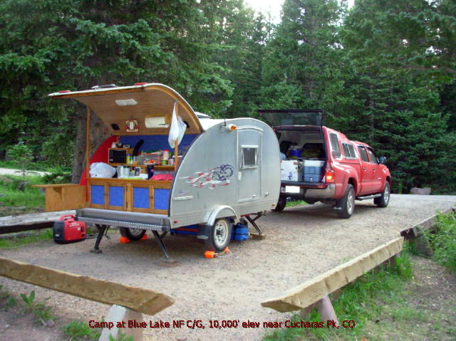

Postby Vedette » Wed Apr 10, 2013 11:05 am
I use the ones in the picture on the front and use 1992 -99 Toyota Tracel jacks (Also $5.00 at our Pick'n'pull) on the rear.
They normally remove these from vehicles before they are put in the yard. But these are mounted above the right rear wheel well behind a panel and are sometimes missed. Thus they are usually brand new (never used) condition and have a good range of movement.
Good Roads
Brian & Sandi
Good Roads
Brian & Sandi
