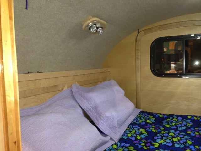

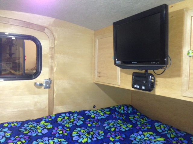

Postby Glenn Quarles » Tue May 14, 2013 11:26 pm
Friends here are a couple of pictures of the inside. Like I said before, it is very simple. All maple with a water based poly to keep the tone of the wood very natural and light.

Re: It's Done!!!! Well almost...
Postby nhstt » Thu May 16, 2013 5:57 pm
Looks great :thumbsup: Is that storage under those pillow's :thinking: I'm hoping to do something like that also. How thick are your walls, and how did you make your doors . I like the trim around them. :thumbsup: The two veneers on the outside are great. :applause:
Postby Glenn Quarles » Thu May 16, 2013 9:04 pm
Nhstt, thank you! Yes those are cabinets in front of the pillows. The electrical system lives in part and the rest is storage. I did my build a bit different than others I have seen here. The sides were completely built on the bench and then the doors were cut out using a very precise pattern and a rotozip. By the time I lifted each side off the work bench, the doors were finished, hinged, the windows were fit, the interior finish was complete and the epoxy on the outside was finished. All the trim around both the inside and outside of the doors are maple. I bought raw lumber and resawed/planned it down to 1/4" for all the trim pieces.
