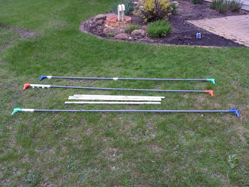

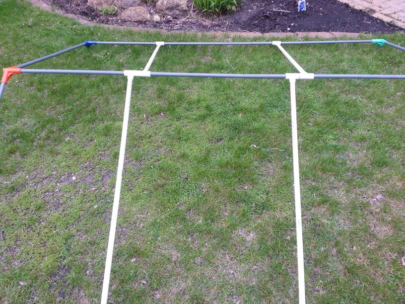

Gary and Cheri wrote:I love the Alcove but like the reviews have said water can pool. I have used plastic 1/2 inch pipe for support. Put 4 tees on the center section and 2 on each of the sides. Then cut a support pipe to go between the tees, two to a side. They slide well and provide a ton of support.

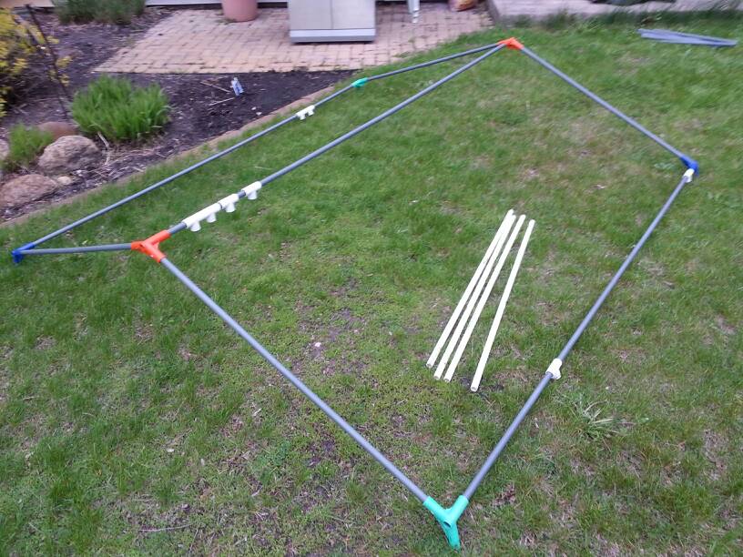

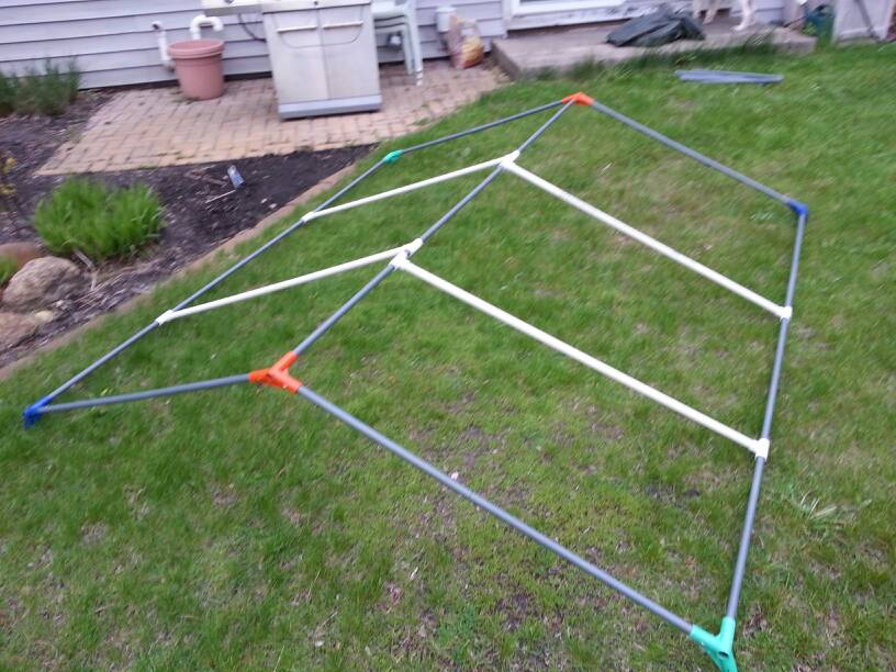

This is what I do. Everything is friction fit.
I leave the "T"s on permanently.

I just stagger the joints and move to appropriate placement.

I really like the PVC hack.

the pipe T's and added cross members looks like an quick easy fix. :thumbsup:
thanks for the idea, much better than ranting about what some people think is wrong with America.
