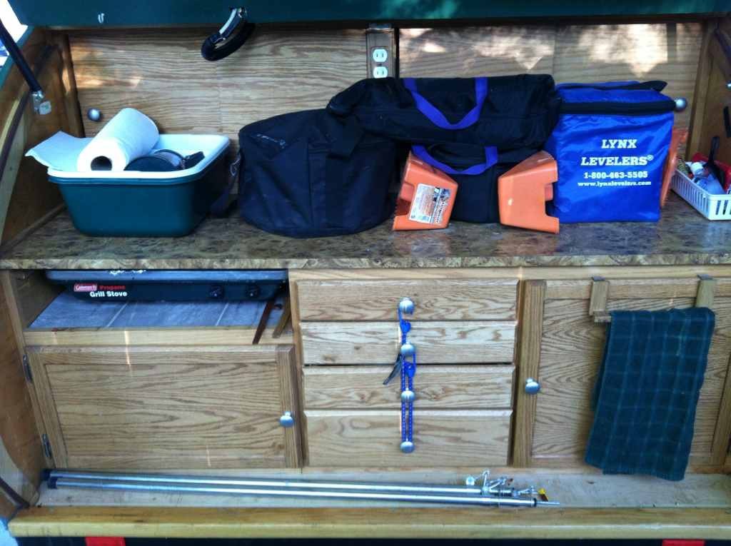

Here is what stays packed in the tear all during camping season
In the galley are things we need immediately after arrival: wheel chocks and leveling blocks, plus heavy stuff(cast iron) cause we are a little tongue heavy.
In the cabin are two camp chairs, one antigravity lounger (sometimes two), three mats, solar light, awning, side tables, pvc sink set up and tearjerker flag, each in individual bags as appropriate, and laying on a big piece of waterproof material to protect the bed.
Because of the tongue weight issue, and because depending on the purpose and location of the camp, some of these things don't go, the following go in the TV: two ice chests, folding bikes, firepit, shower shelter, folding camp table, hot water heater weed sprayer can, charcoal, charcoal starter, 1 gal drinking water, birding bag (binoculars and such) tool bag, games bag, and travel box (maps, atlas, books on cd, meds, glasses, randy's hearing aides, phones, etc.)
These is just the way we do it, of course others mileage may vary!

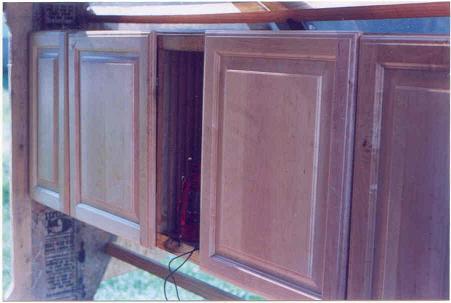

Our tear has an inch and a half foam insulation and an AC and diesel heater (both are not permanently attached). We have the largest tongue box I could find and two PVC pipes used to hold tent/awning poles 6" and the sewer hose 4" (gray water tank). The tongue box makes a huge difference in having a place to put the battery and charge controller for the solar panels and all of the tools etc.
100407
Kitchen was designed by Nancy and set up the way she wanted. With the water heater, cooking and cleanup after are no more difficult than at home.
100406
