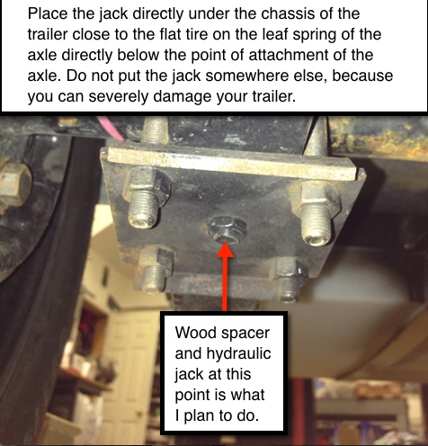

One variation I expect to do is re jack-point. I don't think jacking on frame is correct for me. After digging and re-reading my trailer manual a few times I've come up with what I hope to be the correct jack-point for my TT. The top text is from my trailer manual/manufacturers website, the bottom is what I plan to do using a small 2ton bottle jack.

Postby Dale M. » Mon May 27, 2013 11:47 am
hwitten wrote:
Shadow Catcher wrote:This MIGHT be the reason I can not lock the brakes
Could very well be. :)
Thanks for the YTube link. Confirmed that I remembered correctly from back a few days.
Statement (in pic) seems some what of contradiction, first on chassis then under leaf spring...

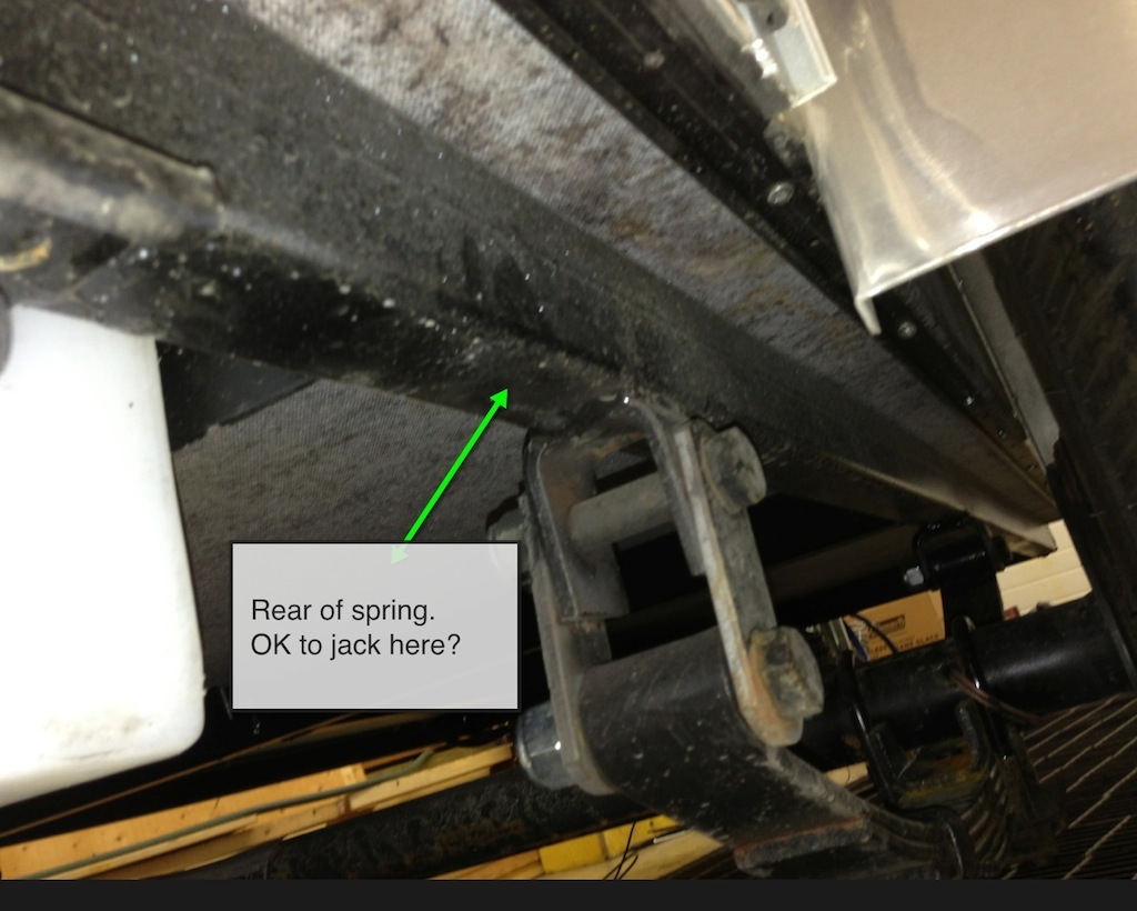

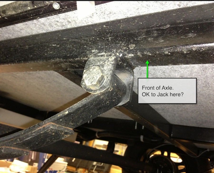

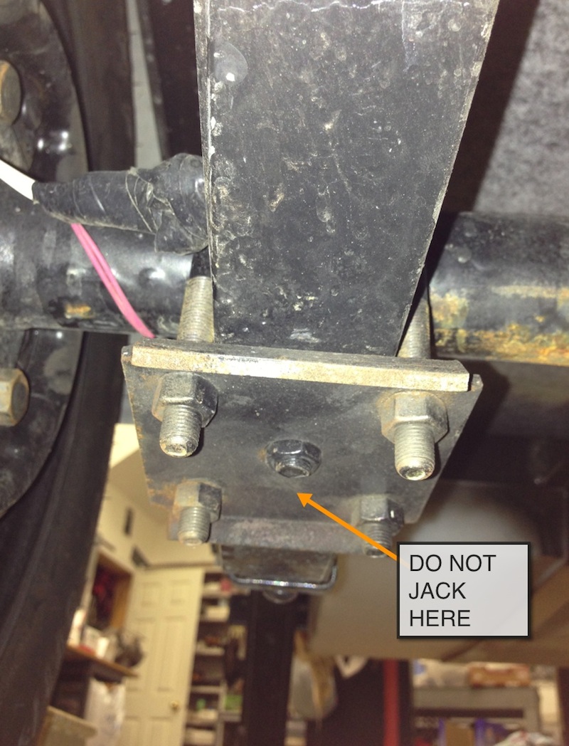

I thought I'd post this last post on the subject of how to jack up wheel to adjust brakes/change tire because I had a real problem wrapping my head around this. Not only were the trailer manufacturers instructions somewhat vague but I didn't find anything better searching the web. Of course could be just my old age not grasping it correctly :)
These 3 images should clarify once and for all. While I asked manufacturer specifically for my TT I would think same may apply for others too.
NO, NO, NO.
YES, ok to jack here.
