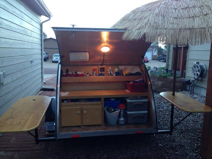

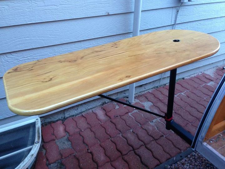

Okay, I had to jump into the fray with my own take on side tables. I wanted the flexibility to rotate them, AND to have my umbrella overhead.
So I have fabricated a metal arm that slips into a channel underneath. Then the table tops are 1/2 birch with two plys around the edges and at the mounting points. The round hole for the post has a metal sleeve. The tables also have a side support arm that hinges back down the upright.
I like it so far. Time will tell how stable they are in use.
Here are three images:

troyp wrote:Okay, I had to jump into the fray with my own take on side tables. I wanted the flexibility to rotate them, AND to have my umbrella overhead.
I like that a LOT! :applause:
