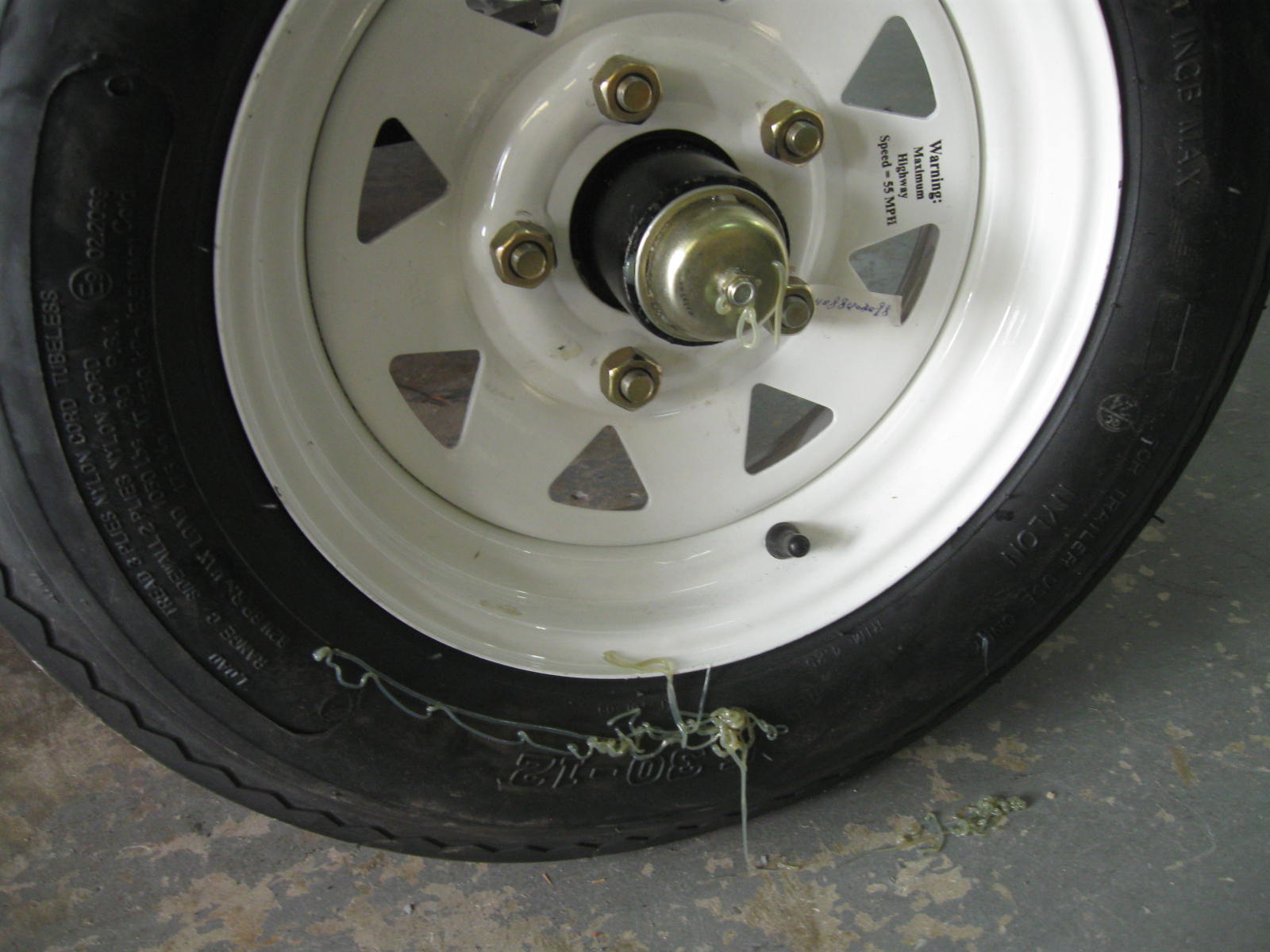

Oil bath is what the M1 series tanks use as well. Very low maintenance. I have modified my HF trailer hubs to be more like the M60 series tank which I was also on for several years. Im glad I did this modification :) grease relief valves
