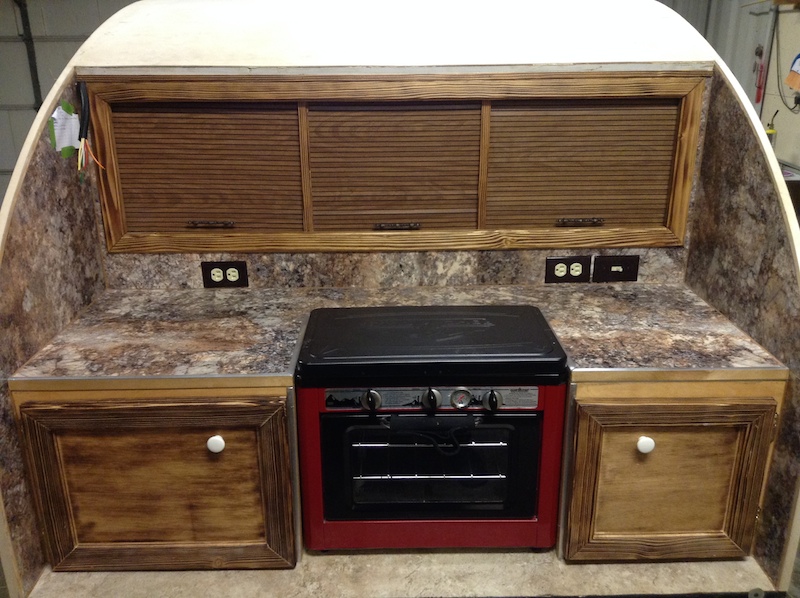

Oh, got my 120 outlets in and deck lid wire for lights.
