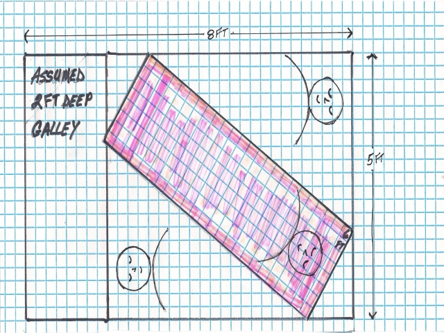

Okay...Please take a look at this:
The picture got a little distorted from scanning and shrinking it for the upload; but, it is using a HF trailer and building the deck over the wheels to make it 5' wide and 8' long.
The bunk is 2' wide and 6' long. ( A submarine bunk is 22" wide and I have slept on a 22" wide cot; so 24" is more than that.) By sleeping as shown, everyone would have their own space and their upper bodies would have the most movement possible. Also, possibly depending on where the wheels and doors are located, I think you would have reasonable access in and out of both side doors.
Oh, and the people on the bottom might have to sleep a little on the diagonal, too, to avoid the wheel well boxes. You may may want to build a bed platform at the height of the wheel well, taking advantage of that with storage underneath and then raise the walls to 4'6" or thereabout.

Very cool idea. How would the diagonal bunk be supported?

You could either support it with legs, like you originally suggested, or add extra supports into the walls to attach it to and then use something as simple as a diagonal wood frame at each end. If you decide to support it with legs, you might want to strap the legs to the corner walls so that the cot doesn't move or slide around; and, you would still need some extra support in the wall to screw into for that. If you want to use canvas and poles, you would need to add in a reasonably good sized diagonal board, with an area cut out for the poles to set down into, and this board would be attached to wall frame supports at the two corners. The advantage of the canvas and pole method is that the upper bunk could be easily moved, removed or added back, according to your needs; and, it would most likely weigh less than a full wooden cot. There are probably many different ways to do it. All of this will take some close calculations; but, I think it just might be very do-able and the abilities that you already listed tell me that you are capable of that.
