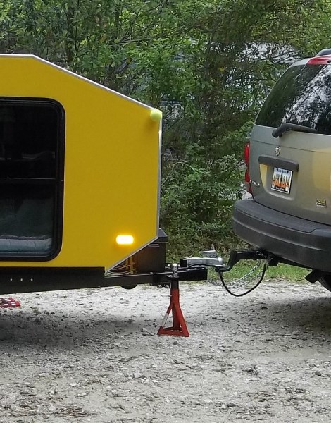

Postby bobhenry » Mon Aug 11, 2014 6:59 am
Reopening an old topic
New pics from this weekends outing........
How to level your trailer.
Hydraulic terrain adjustment system. :laughter:
