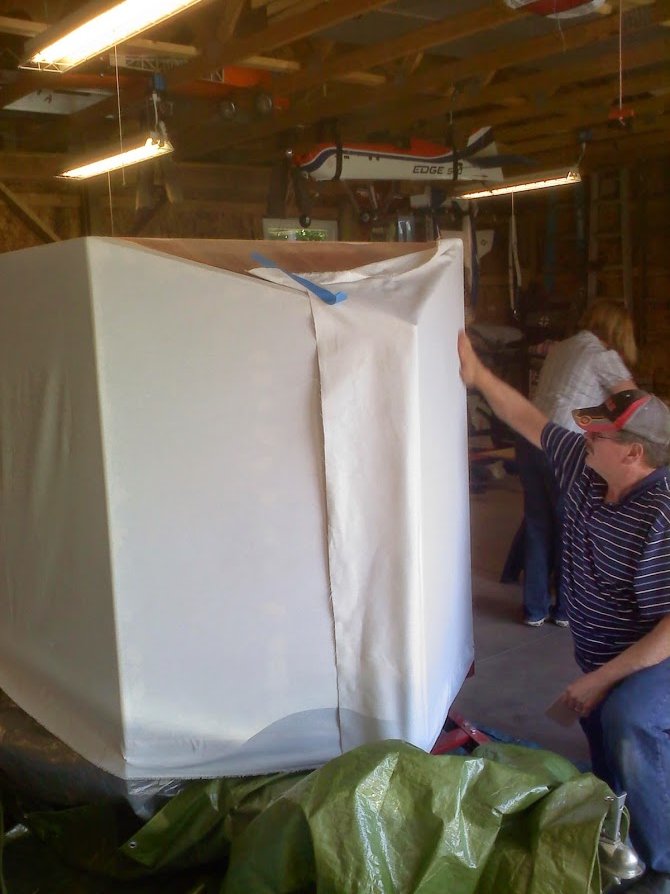

Postby jrjr » Mon Jul 07, 2014 8:26 pm
A couple pics of canvas job - sorry for the quality, took them with my phone

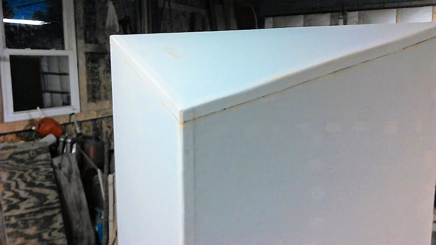

Re: Construction techniques - wood
Postby jrjr » Tue Jul 08, 2014 6:55 am

Postby GPW » Thu Jul 10, 2014 6:19 am
NICE canvas job !!! :thumbsup: 8) :D We see you have some previous covering experience ( RC planes ) 8)

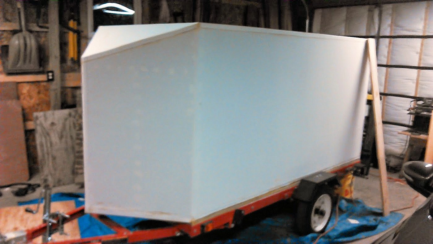

Postby jrjr » Tue Jul 15, 2014 8:53 pm

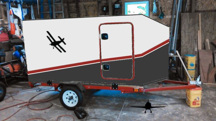

So far I have 5 coats of paint.... almost 2 gallons. I noticed several bubbles. Long thin bubbles one about a foot long. I swear they weren't there before painting but maybe due to the color of the canvas they weren't evident, don't' know for sure. I did the pin prick/iron trick and they seemed to flatten down pretty well. After ironing I rubbed the crap out of them with a piece of scrap canvas. The rubbed area turned dark... like maybe glue had worked out of the pin pricks. Anyway, will check close tomorrow and see how it is.
The canvas is filling in pretty good, maybe another 4 or 5 coats to complete. Sherwin Williams is having a 40% off sale this weekend. Friday Sat Sun and Monday so if you need good paint, there's a chance to get some good stuff at a reduced cost. I will be getting my final colors during the sale.
Here's a pic of my intended color scheme....just a Photoshopped image. The gray will match my car color.......

Postby GPW » Sat Jul 19, 2014 4:21 am
Paint scheme looks real Good !!! :thumbsup: 8) Sometimes those bubbles go away as the paint cures and shrinks ... ;)

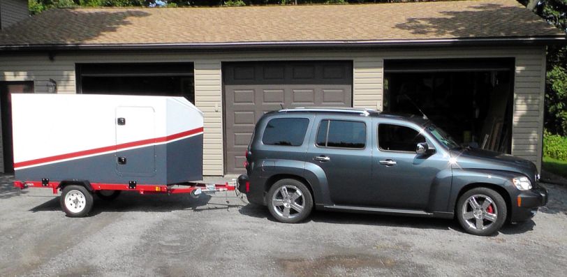

Postby jrjr » Tue Jul 29, 2014 3:15 pm
Here it is ready for the first trip to the flying field -
