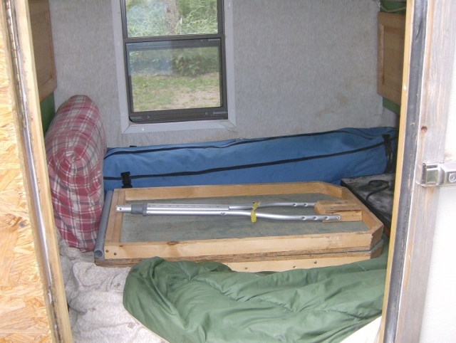

Unless you are both 7 feet tall this galley design is going to be a nightmare. It is just too damn tall for comfortable work. Perhaps you might entertain attaching your outboard counters extending from the side outward instead of forward.Image
This allows you to drop them to a more workable height. It also gets them out of your way when entering the trailer side doors. By adding a second on the other side this would also get the cooking odors outside of the galley proper. Perhaps if you were to build short cubbies under the galley countertop this would allow you to drop the central countertop to a more user friendly height also. This gives you and yours a well ventilated cooking area, a prep area in the center, and a cleanup area where a few spills and splashed water is easily taken care of by mother nature.Image
My little 4x7 is without a galley at all and it serves me well to prep , cook and cleanup great meals. Mine are removable and stack in a 2' x 3' by 6" tall cube inside during transit.

Postby lrrowe » Thu Aug 28, 2014 1:11 pm
Bobhenry,
That crutch makes a great support leg. I am going to have to head to the Goodwill store to look for some. An older wooden one would be nice.
Bob

Postby bobhenry » Thu Aug 28, 2014 3:06 pm
lrrowe wrote:Bobhenry,
One quick note...... The old style wooden crutch must be disassembled and bolts placed in different holes to change heights the aluminum ones are just a push button adjustment.
And yes you do use them more than you would think not all camp sites are pool table level. If you study the pics you will see they were extended about a foot while in use but in transport mode they are shoved in to compact the units as much as possible.
