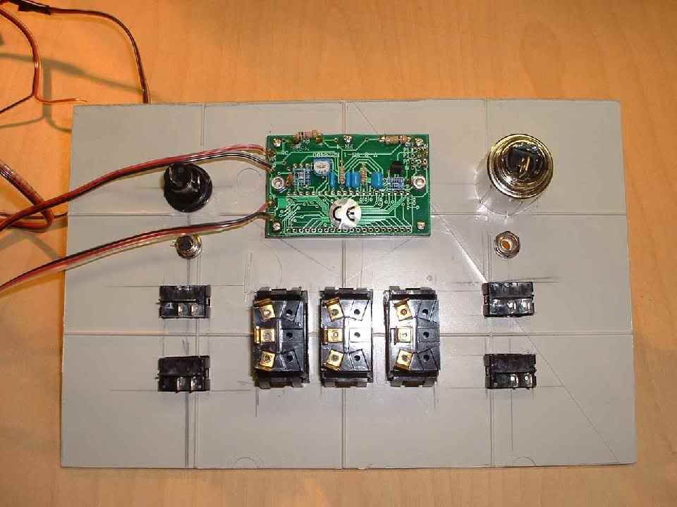

Postby Dee Bee » Sat Aug 07, 2004 7:09 am
Shrug53 wrote:Very nice Dee. Clean job! Can you give us some specs, schematics, rear photos, etc?
Here is the back although the circuits are not wired
DEE
