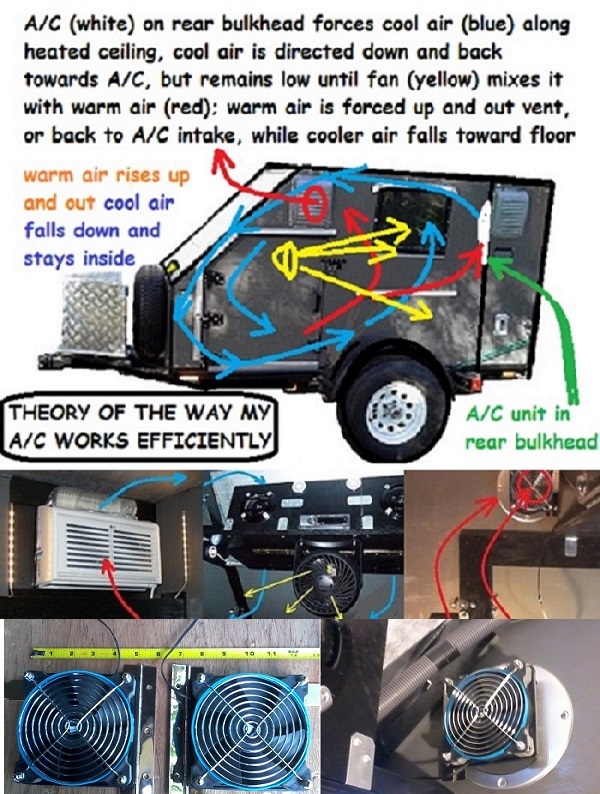

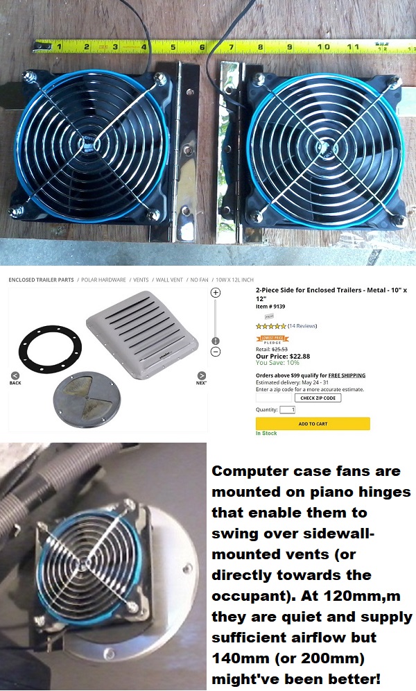

* A) I have two computer case fans mounted on the walls, just below roof level. I can use them to expel warm air, or by reversing them, bring in cooler fresh air (thru insect screens). There are also two awning-style windows, mounted lower, that (also screened) bring in more fresh air (in milder weather).
* B) The exterior housings for the vents are waterproof (they were meant for roof-mounting, so mounted on the sidewalls, are doubly waterproof). I already have a dozen holes thu my roof (though sealed with PL adhesive and coated-over with a flexible membrane), so I never considered a roof vent (well maybe a Flexner, for a moment), and found a waterproof vent instead. And the awning-style windows really perform well, keeping out the rain, unless coming in a sideways gale!
* C) The fans are mounted on swing-outs (and can be turned towards the interior, if only a small bit of airflow is desired, or the main air circulator fan or A/C are not in use), behind a butterfly closure, that seal out dust & airflow, if not needed. I leave them open a bit, whenever I'm in the cabin, to expel moisture & carbon monoxide, no matter the weather conditions. The fans run on 12vdc battery, and consume so little current that I usually always leave them on, even when not inside.
