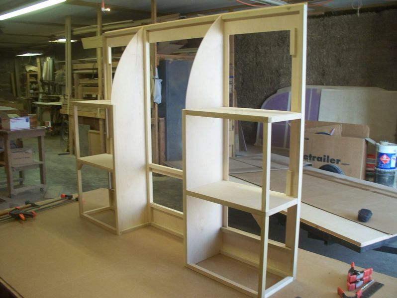

1/8'' baltic birch plywood cabinet face frames and sides, backed with 3/4 X 3/4 cleats make very lightweight cabinets and cedar doors and drawers....Focus on lightweight lumber, poplar, soft maple, cedar....My 5X10 is 1000 lbs. viewtopic.php?f=50&t=57906
