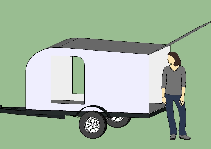

After browsing this discussion and looking at ecomodders, etc. I've revised my design to be more aerodynamic at the expense of not looking like traditional teardrop. I used a slight (about 5 degree) slope on roof with a flatback and recessed vertical hatch. This has several advantages: more room inside, easier hatch build, hatch hinge and side seals will be out of the wind stream reducing water infiltration. Disadvantage is that galley access will be more restricted due to headroom. I could install double barn doors to eliminate headroom issue and simplify build. This sketch doesn't show all hatch details, just general profile.
I'd love to hear from you experienced builders out there, thanks.

The large flat back of your trailer is going to be horrible for drag in my lay opinion. Take a look at these images of the affect of drag on different shapes:
https://www.google.com/search?q=drag+sh ... 24&bih=507
You may agree that the shape of an object's rear is extremely important in reducing drag. With a teardrop, one could hypothesize that since it's behind a tow vehicle, the rear is the most important part.

Postby ChasCABQ » Wed Oct 29, 2014 3:41 pm
tony.latham wrote:The large flat back of your trailer is going to be horrible for drag in my lay opinion. Take a look at these images of the affect of drag on different shapes:
Thanks for your opinion and the link. Everyone who's replied has helped me refine my design.
I agree that a true teardrop would have the least drag particularly with the shape oriented in plan versus profile BUT it would end up longer and harder to build than what I would like. I reviewed aerodynamic websites and car designs to decide that flat back is best for my skill level not to mention increased space and hatch simplicity. See also http://en.wikipedia.org/wiki/Kammback which notes the improved aerodynamics and constructibility of a flat or Kamm back. I plan to include a recessed galley hatch so the sides and top extend past the hatch a few inches with a sharp edge for a cleaner break in the airflow. FYI my TV is an Outback with similar cross-sectional area and height.
Check out the rear end of Corvettes, Tesla model S and Toyota Prius which use a flat back at the trunk. Also one of the links you referenced had a chart showing that a bullet shape is not bad at all http://www.cervelo.com//Media/images/Aero---Shapes-and-relative-drag-05dc9844-8960-4f76-93ad-4d5305ce5262-1-630x362.JPG

Postby tony.latham » Wed Oct 29, 2014 6:49 pm
Thanks for the education on the Kamback. I wasn't aware of that funciton, but have sure seen it on the 'vettes etc.
