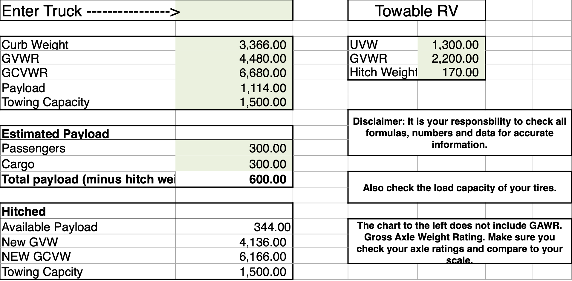

Thanks so much for this information! I am brand new to the forum and to the teardrop trailer community. I have a 2020 Braxton Creek Bushwhacker, and had planned to tow with my 2014 Forester. I have crunched the weight numbers several times (using worksheets online), have read the Forester forums, and called every mechanic in town, including the dealer. And no one seems to have the same answer regarding the CVT, whether I should install an after-market transmission cooler, etc. No one in town wants to install one for me, and finally I got someone at the dealer who said that I shouldn't have a problem with my Forester, other than possibly having to change the transmission fluid more frequently. I like this answer best because I love my Forester and cannot necessarily afford to get another TV. The dealer also highly recommended NOT adding any aftermarket equipment because of my warranty and also that the engine simply doesn't need it (according to him).
I also am excited to use my teardrop, but I've been sort of immobilized because I don't want to damage my Subaru. The dry weight of my trailer is 1330 with a tongue weight of 125, but I added it up to 170 to account for the propane and battery (I included a snapshot of a worksheet calculation here). I won't load the trailer at all, and will try to keep my packing conservative in the car itself. But I live at 7200 feet, and so leaving town always entails some serious elevation changes, and the trip I need to take this summer entails crossing the Rockies. I guess I'm interested in what you all think!

Re: VISTABULE Teardrop Trailer arrived
Postby pchast » Tue Mar 09, 2021 9:31 pm
HI and welcome...... :D
I tow with an Outback. The car came with a trailer hitch(used) so I'm careful.
My td is lighter by 3-400 lbs but I also use a utility trailer to move a Motorcycle
or a load of stone for the driveway.
I bought the car with 50000, had the CVT oil changed at 90,000. It was brown. I'll
have it changed again soon. I bought a 'Scangauge II' to watch the engine coolant
temps. Its never displayed over 210 degrees. I've never had the big changes you
will deal with. I figure I'm at about 15000 miles towing now.
Postby karathomps » Sat Mar 13, 2021 7:25 pm
Thank you Pete! I would feel much better about towing with an Outback, though I guess the transmissions are the same. Good to know that the towing definitely seemed to have an effect on the trans fluid. I just had mine flushed and changed, so I might take the dealer's suggestion to take it on a couple of trips and then bring the car in for a fluid check.
