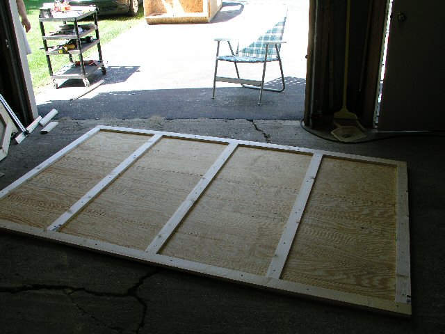

That's it for today. I now have a floor, 1 complete wall, and 1 partial wall...
That floor is 5' x 8' by the way!!!

DANL wrote: About the floor, that was someone else. I remember the post you refer to but don't recall which heading it was under. My floor is one-half inch BCX on two-by-two framing. Seems quite strong.
I ended up using 5/8" bc plywood. It's a little heavy, but not too bad.
