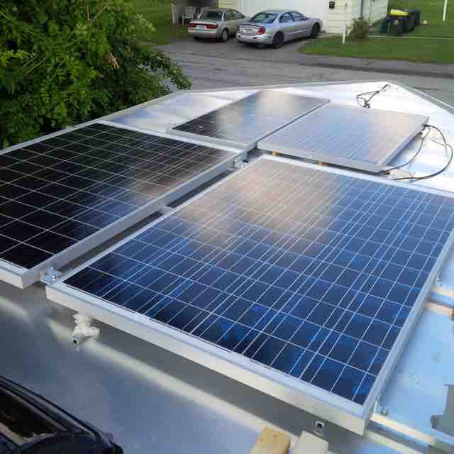

I have poked so many holes in my roof and I seal all the penetrations with 3m 5200. Here is a pic of my solar array and charge controller. I made all the frames for the panels so I could easily remove the panels without changing or removing the penetration bolts.
