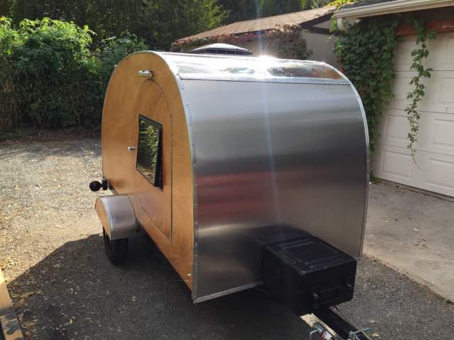

Postby Bigwoods » Mon Nov 02, 2015 10:12 pm
Mine is built on a 4 X 8 Harbor Freight, although I widened it to 5 feet.
