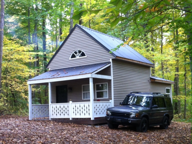

Thanks for your input on my just launched build profile. I looked at your build thread and was blown away with your build. I really like your design and your execution. I do have a question for you - if you wouldn't mind... I don't plan on taking this offroad at all but I want it to look capable. How much trouble was it partially recessing the wheels/tires into the body area? I had originally planned to go that route but thought it might just add a lot of work. I would be interested in your thoughts.
Regarding my skill level - this is my first ever trailer build but I did recently build (pounded every nail) an off-grid cottage on some property we own. I am pretty comfortable working with wood. I am having my trailer frame welded up next week by a pro. For some reason this trailer build has me more aprehensive than our cottage build - I just need a kick in the pants to get going! :)

Nice cabin. I want to do something simular.
You will not have any problems with the wheel wells. Easy to make. You can even just box them instead of the hex sided shape I made. The biggest issue is making sure the opening is big enough for the tire/wheel combination you plan on using.

If you can build that beautiful cottage....you can build a TD. :thumbsup: :thumbsup:
Just get you plan in your head or on a blueprint if that is how you are used to working, and start building! :twisted:
