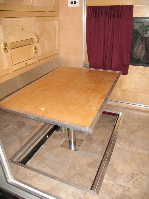

I cant believe no one has posted pictures of inside seating! Here's how I did mine:

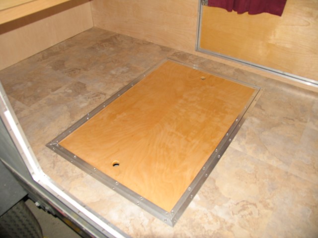

I framed in the bottom of a section of the harbor freight trailer and made a removable lid:

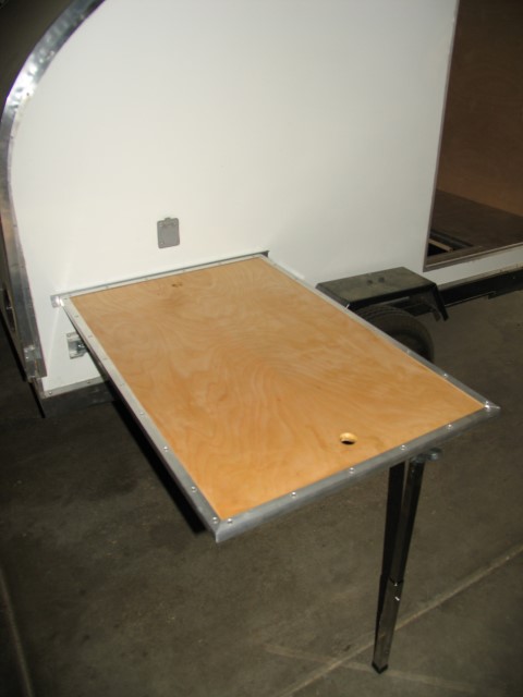

The lid serves as a table. Here's a photo without the cushions:
I added a leg and some hardware so the table could be used outside the trailer as well:
I cut the mattress in sections so that they could be stacked against the back wall when the table was in use. While it seemed like a great idea we didn't use it very often. It so cramped inside the trailer that it was a pretty tight fit for the two of use. I don't think I'd do it again if I built another trailer.

bdosborn wrote:I cant believe no one has posted pictures of inside seating! Here's how I did mine:
I can't believe it either! :lol:
Bruce, thank you so much for the great pics, that's exactly what I was hoping for when I started this thread! I knew I saw something like that before, but couldn't find any examples by searching. But you're suggesting that it's not really worth it to bother with the inside table? I'm starting to feel that way myself, especially after others pointed out that you could sit out a rainstorm in the tow vehicle, or use a small fold down table or a "breakfast in bed" try on the mattress in a pinch. I will, however, definitely be doing those side tables off the back sides of the camper, that has always been in my plans, though I may forgo this idea of an inside table. Could I please ask what kind of mattress you used? Was it memory foam, latex, or something else altogether? Did you cut and apolster it yourself? And did you build benches for the seating, or just sit on the cushions when you used the inside table? Thank you so much for your help!!
