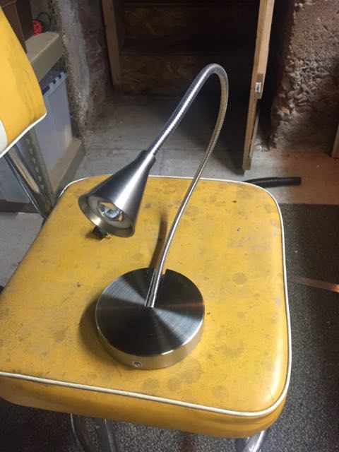

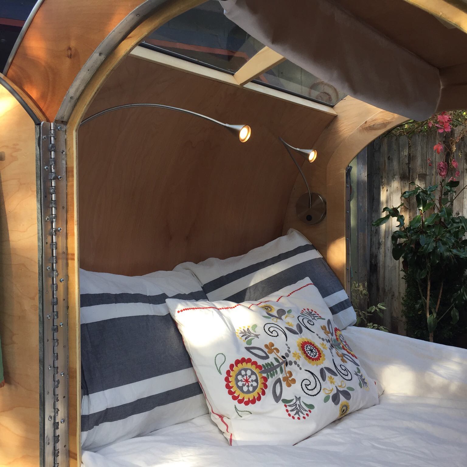

Postby Kanook » Sun Feb 14, 2016 2:52 pm
I bought these ikea desk lamps for mine. I gutted the weight from the base and used cigarette plug USB adapters to bring 12v to 5v and added a small toggle on and off. Works perfectly and you can adjust the light to any direction.
