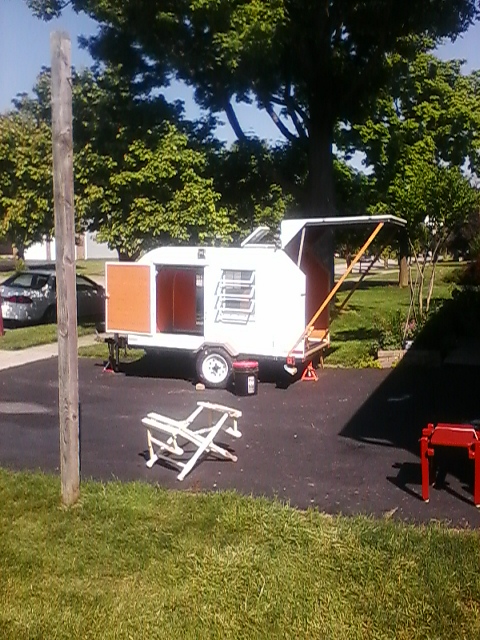

Curtain around hatch for privacy.
Stand under hatch.
I wanted a small camper for a good nights sleep but we needed a small cargo trailer for the kids moving and my old motorcycles. The standup space under the hatch turned out to be a wonderful plus.
