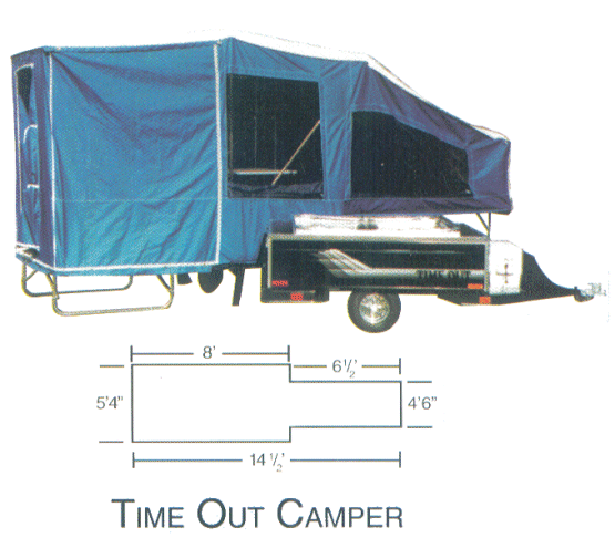

You could perhaps buy the canvas tent portion & build and build the trailer to fit it.

Now THIS is what I'm talking about. Light, easy build. Making the tent is the difficult part. I love it.
Glad you like it, so do I and that is why I posted it on my thread of unusual designs found on the internet
http://www.tnttt.com/viewtopic.php?f=5&t=64495.
But a word of warning: The images I post are links to the original page (which I usually include as a separte link when it contains additional pictures and/or info). Those links are lost when the orginal page drops them. I lost the links to two pictures of one of my favorites, :cry: an end (side pivioting) A-Frame which was nearly identical to a design I put together decades ago but never built (although I did make a working cardboard model). So do not relie on my thread to forever store photos & info that you find important.
I like the fact that his pop-up design has a rather simple tent top, just straight seams that lend themselve to home fabrication. But he also has many other clever ideas that are visible in the extensive photos on the orginal listing. His trailer looks like it can be built a bit lighter with a little attention to the heavier items.
