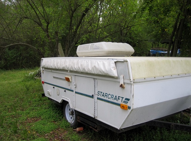

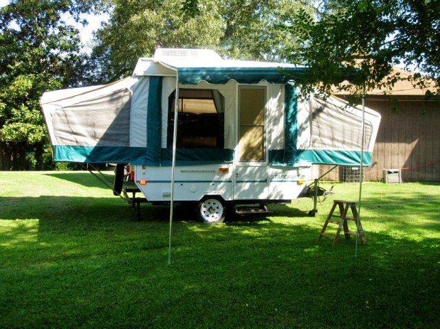

I have a small (8' box) 1995 Starcraft Meteorite pop-up trailer. It's one of the smaller units but it definitely ain't lightweight. I throught it'd be light but after pulling it on a couple of trips as my hunting rig, I took it to the local CAT scale & had it weighed. Knew it wasn't light bet was surprised that it weighs almost 1500#, with a hitch weight of more'n 150#. I realize that the AC adds to the weight, & I have a battery under one dinette seat but even together I don't think they weigh more'n a couple hundred pounds. I still use the trailer for my hunting/fishing rig, just not as much as I used to. I've recently bought a '99 Ford F-250 Super Duty pickup with 7.3L power stroke diesel, & a 2003 pop-up truck camper, to replace the Starcraft, & my old '85 Ford diesel & pop-up camper that was totaled in Nov 2014. The 'new' Ford diesel actually gets better mileage hauling the pop-up camper than my Toyota Tacoma towing the Starcraft trailer. I've used my TD for lotsa hunting/fishing trips but I usually need more room & the pop-up campers provide that...

I've been doing a lot of research on pop up camper empty weights. This is from the NADA RV price website.
A 1995 StarCraft Meteorite model 817 is as follows length 17'4", width 6'6", sleep 6, and has an empty base weight of 1140 lbs. when you add options (AC, battery, full propane tank, water and camping gear) 1500 lbs. is quite possible.
But when you look at a 1990-1994 starcraft Meteorite the base empty weight is 902 lbs. a 238 lbs. difference.
