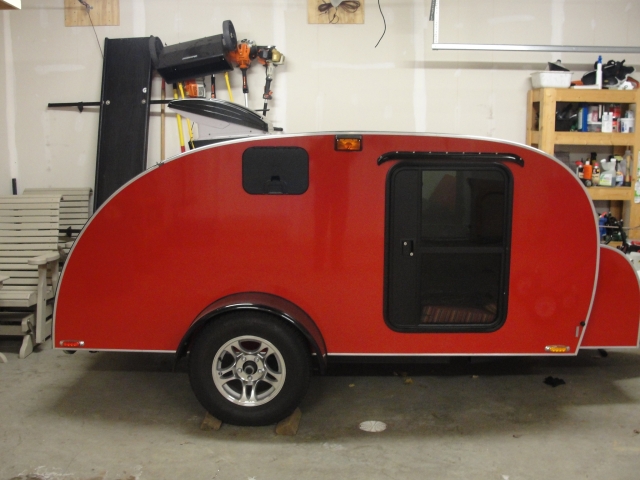

Pictures of MaxAir Vent Fan
Postby Dusty Mark » Sun Dec 11, 2016 9:46 pm
Here are the photos you requested of the Max Air vent fan on my teardrop build.
This is in the closed position. Note, that my installation is far to the rear and over toward the passenger side because I also use the fan to vent the hot air from the back of my air conditioner. I raised the back end up over an inch so that the fan is installed in a more level position that looked better to me.
This is the open position. It's nice to be able to run this fan in rainy conditions.
