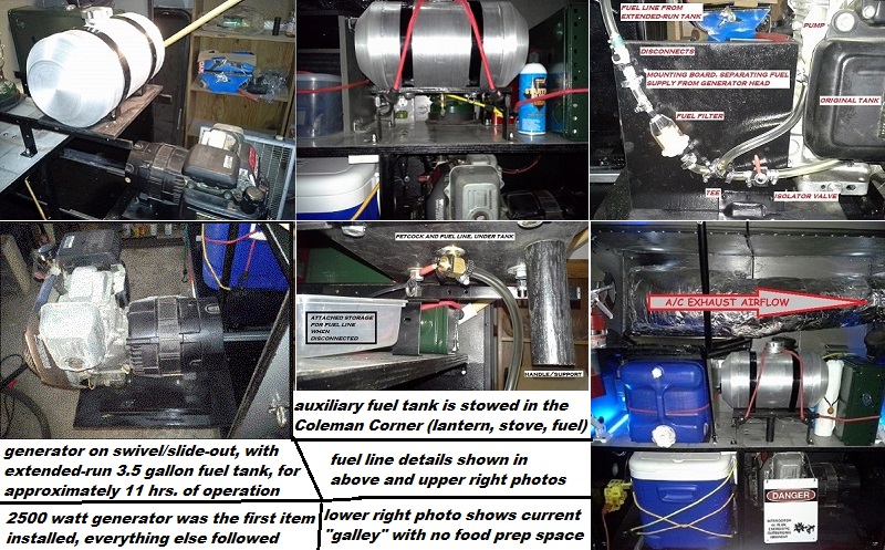

* Like you, I use side-tables, pop-up tents and canopied for sitting area, cooking area, changing and toilet spaces ... I have a galley, but it's not a galley, due to other priorities taking up the space. The first item I installed in the trailer was a 2500 watt generator, to run the 5000 btu A/C I planned to install later. Since the trailer is a 4' x 8' squareback, I put the generator on a swivel platform, mounted on a slide-out, in order to fit inside the 21 inch space allotted for it (I fitted an interior bulkhead at 22 inches forward, which left room for a twin-size mattress in the front). I still envisioned having space left above it for food item storage and a prep space. Until I decided to make the future A/C able to run fully enclosed inside the galley (hatch shut and locked at night, if park power was available).
96778 compact generator (on swivel base that also slides out), 21" deep, 24" wide, 16" high
104739104348104740
drip-pan/support, right-angle exhaust boot, insulated ducting routed out thru side-vent
* Fitting the A/C and its' bulky exterior shrouding, ducting, exhaust booster fan, and drip pan/support, took away all of the upper half of the vertical galley space, and half of the upper shelf. That only left me with barely enough room for a cube cooler and space for Aquatainer on the streetside, and space for my Coleman gear on the curbside shelf. Later, I managed to squeeze-in an aluminum fuel tank for the generator, so there's absolutely no room for "galley"-type gear (other than the frozen food in the cube cooler, and the Coleman stove folded-up on the shelf. I carry all my utensils, pots, pans, canned & dry food items, and my small BBQ grill, in storage boxes on my front or side racks.
generator, fuel, & Coleman gear take half of galley space.jpg (244.35 KiB) Viewed 1326 times
* Though it was the first item installed in my trailer. I've never used the generator at camp, nor the Coleman Northstar lantern (never fueled up ,either) in the corner of the galley. My right-angle A/C exhaust ducting could've been vented directly thru the closed hatch (sealed-box with louvered vent), and the hand-formed A/C drip-pan has never been dripped on, so both features weren't really needed, and could've been eliminated, freeing up 75% of the galley for food prep and storage. So, if I had to build it over again, my galley would actually become a galley.

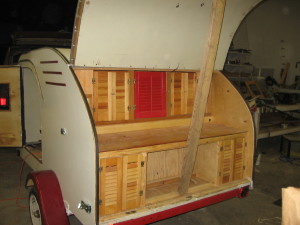

This is my galley before the props were installed. The only reason the middle door is red is because when my Grand Daughter first saw it she said, "Why don't you paint that door red?" So I did. We have had great times in the Northwoods.

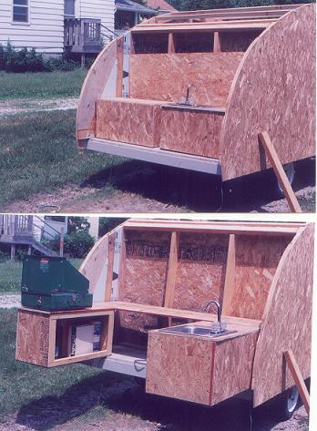

Build picture without the clutter shows the jack knife like storage idea my dear Miss Vickie though up !
Re: Gallery of photos of year galleys
Postby NevadaBlue » Sun Jan 19, 2020 7:32 pm
That is a classic Bob. I am copying it, sort of. My trailer is a square back, but the cooler and cook stove will be swinging on doors at the rear. Thanks for the inspiration. :)

That’s awesome.
