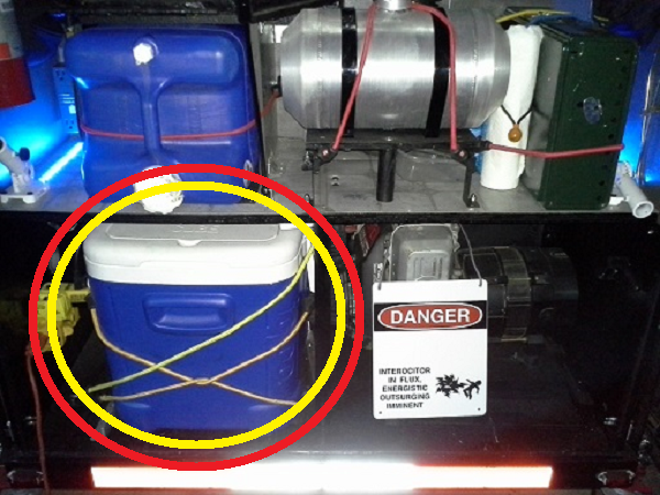

  • I considered a mini-freezer, but only to convert it to a more efficient mini-fridge, as shown on several YouTube videos. I don't want the food inside totally frozen, but kept at just above freezing, for safe use later. An icemaker just makes ice, right? I don't really want to be constantly moving ice to my other coolers, though I considered that, also. I have three 400 watt inverters I could use, but I don't think that's enough wattage to power even a small dorm fridge. Besides, they're very wasteful of energy, so I would rather just keep a non-powered cooler that works, and not add to my power usage.
  • Then there's the space issue. I don't have room inside my galley for anything larger than my cube/cube. A 1.1 upright fridge would fit, but would add heat into the galley area, and not cool my perishables to a low enough temperature, since they are only capable of cooling 40-45 degrees below ambient temperature, which in Texas, could be upper 90's to high 100's, at any time. 100 degrees-40 degree cooling capability would keep the food at 60 or so, which Gordon Ramsey would throw a hissy fit over. And that would be after running the fridge at it's highest setting, using a lot of energy, and heating up the galley area (where flammables also reside).
    trailer galley (very little room for cooler).png (453.4 KiB) Viewed 1024 times
    the cube was chosen as the largest size to fit in this space
    outer shell size.png (96.67 KiB) Viewed 1024 times
    I could squeeze in a 20"x20'x20" cube, at most

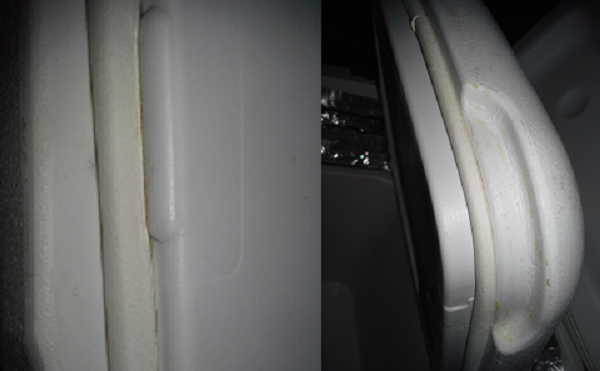

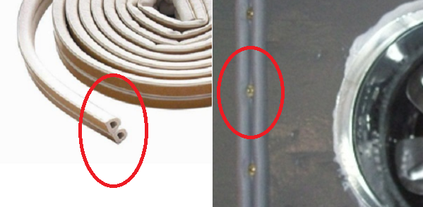

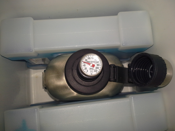

Postby working on it » Wed May 31, 2017 7:45 pm
working on it wrote:... I still need rubber (or foam, compressible type) to seal the plastic lids against seepage. I made a thin aluminum bar to help open the inner lid more easily, and it sits in front of the inner cube, on top of the new insulation. When I opened the outer cube at test conclusion, I picked up the aluminum bar to open the inner lid, and the bar was cold. That indicates that the inner cube is leaking "cold" from around the plastic lip. I'll try to find this type, which sticks on...
  • Got the EPDM Foam weatherstrip via Amazon yesterday, and just now used one -half of it (there are two strips joined in the center; I separated them, and used all of one side). I attached the seal to both lids, on the outside inner edge, so it will seal the gap(s) when closed. I'm not sure how well the adhesive backing will hold, so I'm going to let the cube{s} stay closed for a few days, and see if the seals will stay in place, before the next test. If the adhesive doesn't hold, I'll attach the spare strip of material with Loctite Marine Adhesive. After that, if it won't hold fast, I've got an alternative plan....
    epdm foam on lids.png (287.04 KiB) Viewed 990 times
    thin foam rubber to seal cold leaking out
    EPDM foam weatherstrip, marine adhesive.png (174.51 KiB) Viewed 990 times
    self-adhesive tape, or extra grip adhesive

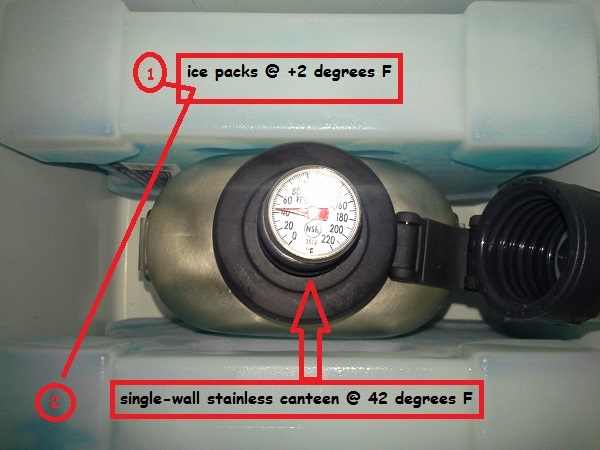

  • Start of new test (2145 hours, 6-7-2017). EPDM foam tape has adhered OK, so I am duplicating the prior test procedure to see if the new foam barrier will make a difference.
    test with foam seals 2145 hours 6-7-2017.jpg (88.16 KiB) Viewed 953 times
    temps. only slightly different from other test start

Postby working on it » Sat Jun 10, 2017 9:41 pm
  • Results of test 1: 60 degrees. (60-41)=19 degrees rise, over 72 hours, equals .2639 degrees an hour, in moderate ambient temperatures. Not as good as I had hoped for, but with more cooler protection (a wet blanket on top?), and a rubber seal inside the lips of both cubes (I never found my leftover weatherstripping to use before testing started), and perhaps more ice inside and/or partially freezing the foodstuffs inside...this cooler may actually work. I'll try another test, soon, after improvements
  • Results of test 2: Exactly the same 60 degree temperature, in virtually the same test conditions and time span. The additional EPDM foam seal didn't help at all, despite what I thought would be a leak-proof lid (both lids were sealed with the foam strips). Unless my next, and final, modification in my quest for a cold cooler, works as I hope, then I'll have to partially freeze the contents, and give up on the "ice packs" (which seem to loose their "cool" way too quickly), and resort to regular ice. Another cunning plan, all for nothing.
    results 6-10-17.png (418.31 KiB) Viewed 951 times
    picture speaks for itself; no better than test 1

Postby Socal Tom » Mon Jun 12, 2017 11:21 am
It takes about 144 Btu/pound to melt ice, and warming the water from 32 F to 62, requires another 30 Btu. So 174ish Btu/lb in round numbers. Assuming you had 2 pounds of ice ( meaning water) then the ice chest took in around 350 BTU ( not including the BTU absorbed by the water in the jug) Assuming you had 2 lbs of ice, then 3 lbs should do the job for that time period under those conditions. To improve your odds of success, pre-cool the inside of the cooler with the ice packs for a day, then add the 3 lbs of ice.

Postby working on it » Mon Jun 12, 2017 12:54 pm
  • My next/last plan is to use a piece of the mylar-faced denim insulation I used to make a "cozy" for my large Coleman Extreme cooler (if I can find the remaining scrap I had left), or use a section of the foil/fiberglass ducting insulation (with the tube removed) leftover/spares from my A/C install. I'll just remove the hard foam insert I put on top of the inner cube, and stuff this other insulation on top, before strapping the outer lid closed. Might help a little. Other than that, I'll follow your advice, and use real ice (nobody nearby sells dry ice, to try), pre-cooling the inner cube.
  • MADTRAPPER wrote:I'm going to try the dry ice at bottom of cooler toping off with ice. cubes. Wrapping the hole cooler in a insulating blanket.
  • If I find enough insulation scraps leftover, then maybe a cube "cozy" will follow.
