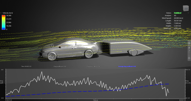

Postby timm » Thu Aug 30, 2018 12:45 pm
The rounded teardrop shape is slightly better aerodynamically than a box.
Here's a CFD simulation of my car. About 265 N of drag force
Now compare this with the same car pulling a 5x8 enclosed box trailer.
Now the drag force is up to 820 N, that's a 210% INCREASE in drag force over just the car.
Compare this with a standardish teardrop.
The drag force is up to about 710 N, which is still a huge 167% increase, but considerably less than the box trailer.
Now compare this to a trailer that has been designed specifically to be aerodynamic.
This is my current design, it's a hard shell pop up with MORE internal space than the rounded teardrop above, yet the drag force is a mere 444 N, only a 67% increase in drag compared to the car. Literally 100% less drag than the normal teardrop.
Here are all the numbers:

Postby timm » Thu Aug 30, 2018 1:35 pm
Thanks, it's been fun running these simulations.
The program is Autodesk's Flow Design, I have access to it with an education license. You might be able to get it with a hobbyist license but I'm not sure.
You'd need an accurate 3D model of your tow vehicle and the trailer, but yeah you could see what the drag force is.
