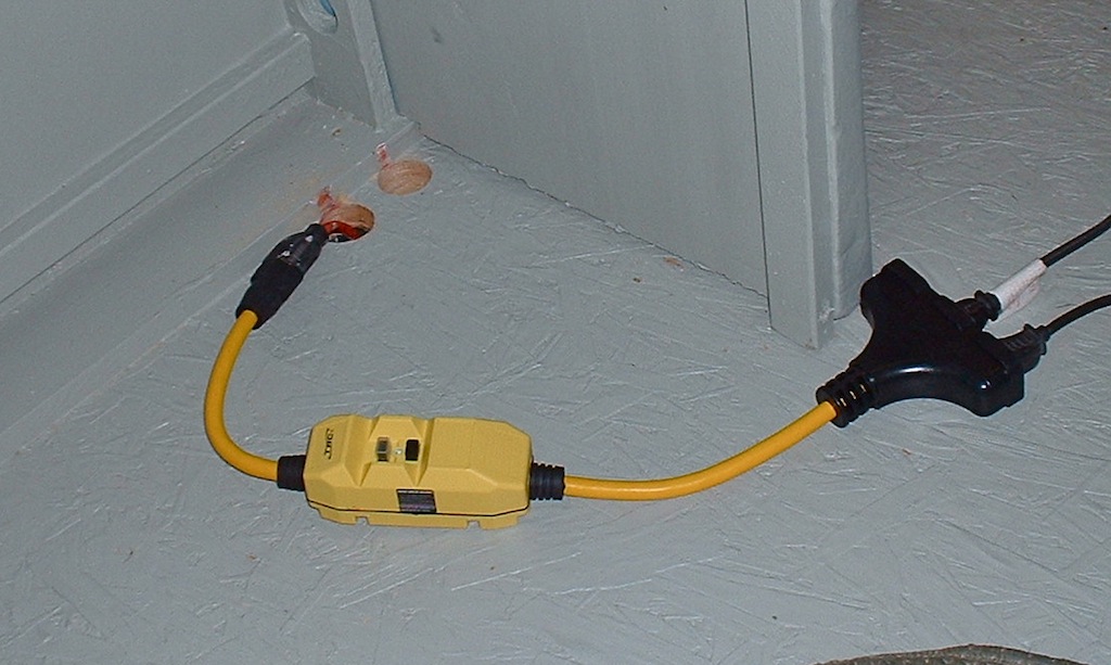

Tony , here’s a pic of my electrical system … I went with something simple and interchangeable should something go wrong … With my SIMPLE camping/EVAC needs , it works out fine …
Sorry , I made no attempt to make a Fancy RV style camper trailer … just a portable shelter for times of need … ( viz, every summer :o )
With these “storms of a lifetime “ happening yearly now , we feel the need for some type of “ bugout” vehicle … :frightened:
And then we have a small generator , an old Harbor Freight 45 watt solar setup (next to worthless), many solar powered lights and a solar lantern , solar cookers , chargers, batteries .. etc.etc. ( and a AC/DC powered TV ;) ) everything carried in the back of my Pickup truck (with my "paw paw" camper top) :lol:
Ps. any electrical cords I can easily thread through the holes in my ribs to any point on the trailer …
