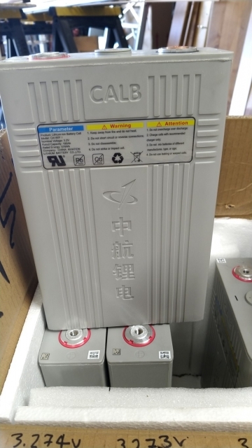

Postby bdosborn » Wed Apr 24, 2019 8:47 pm
Woohoo! There's a new battery on the block!
:twisted: 8)

Postby MtnDon » Thu Apr 25, 2019 8:17 am
Quality cells!! :thumbsup:

Postby tony.latham » Thu Apr 25, 2019 9:08 am
Bruce:
I'm thinking they are just lead-acid bats with gold plates surrounded by heavy water. :frightened:
They do look sweeter than a leaky DieHard that's fer damn sure. :thumbsup:
