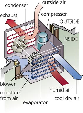

This is going to be my project this winter. Love everyone's setups! I see some of you have piping for intake and exhaust. When I am looking at the front of the a/c, what side(s) is the exhaust on? What am I missing? I don't know the ins and outs of an a/c unit lol

Dahlia47 wrote:This is going to be my project this winter. Love everyone's setups! I see some of you have piping for intake and exhaust. When I am looking at the front of the a/c, what side(s) is the exhaust on? What am I missing? I don't know the ins and outs of an a/c unit lol
Above depicts a typical window AC unit.
Notice that when the window is closed down onto the unit, the outside air and inside air never mix, because there is also a partition wall inside the unit separating the front of the unit from the rear of the unit.
