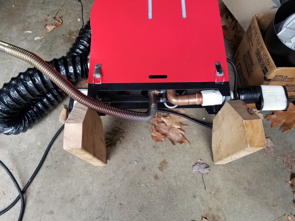

Postby rbtrary » Wed Dec 09, 2020 1:23 pm
Slim seems like the kinda guy I want to have a beer with
I have the model in his video however, and with all due respect, Slim video comments ...
you want a light steel chassis, its portable, carry heavy steel is unnecessary as
the major workings are safely enclosed in the actual heater at the bottom.
That tank shelf engages a lip on both ends and
there are locator pins thru those top handles that mate to holes inthe sides.
with bottom clasps closed makes for a rigid case.
mount it on standoffs, why drill holes, its portable.
Of course the blower is at full blast because the regulating lcd thermo stat needs to be in the
enclosed heating space to regulate. mine is in the cabin. thermo just snaps into a
two screw mounting bracket.
when lcd thermo reaches the desired temp that fan grows ever quieter until whisper quiet to maintain temp.
Hope he shows that.
too bad his exhaust pipe split. cause looks like the bend was too severe, mine was/is fine and sound is barely audible at
set point temp even with muffler removed.
of course its somewhat hot to touch but never that outrageous glowing red hot pictured earlier.
I did splurge $10 to replace the flex intake with 1 inch copper elbow and solid plastic pipe filter combo.
I may neaten up the exhaust w/similar metal pipe
