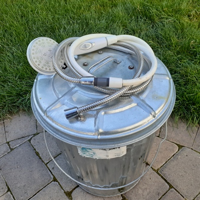

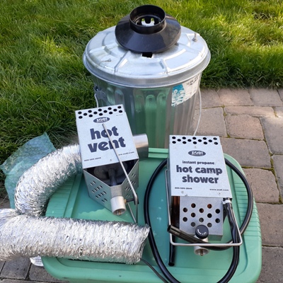

Garbage can has a 12v pump hanging by bolt in lid to recirculate the heating water, dish sprayer; after the dishes are done put the shower head on :lol:
Oh sorry this was about the heater :R it has a little fan inside the tubing 12v to recirculate the Air (ZODI) brand name! Mine is Tim Talered. Thank's Tim
I may need to leave the chuck box I haven't made yet; Home so I have room.

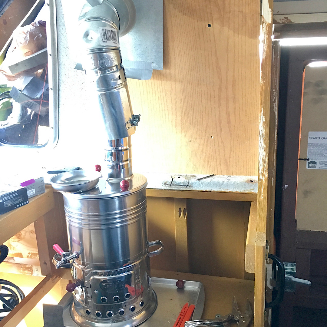

A wood stove is an option. Lots of small stoves are made for sailboat use and many are used in boats that have a cabin that is ‘teardrop’ sized.
I’m planning this... if I live long enough to finish it and live through the use of it, I’ll report back. :D
The pipe looks wonky in this pic because it was just a test fit to see if it actually would fit. It is a stainless Savovar with a wood firebox in the bottom and water heater tank on top. My plan is to heat the cabin in the evening and let the fire go out. The water will hold some heat for a while. Then in the morning, fire it again. So, I’ll have hot water for tea or coffee or soup, or bathing or whatever along with heat in the cabin. Maybe... :roll:

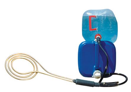

Re: Alternative Heating
Postby twisted lines » Sun Dec 27, 2020 1:32 pm
The buckets are not included so plumb as you wish :thinking:
No thermosiphon either.
fire coil.JPG (20.48 KiB) Viewed 1308 times
