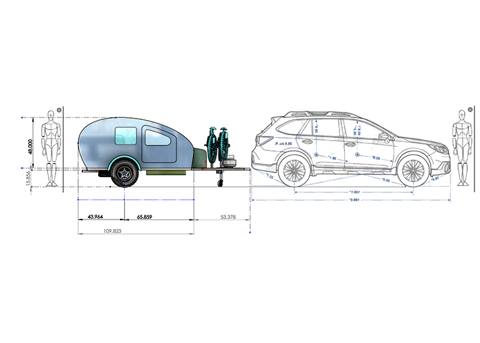

Also.... can my axle positioned be confirmed I have that correct (following the 60/40 rule). I'm not sure where to start the measurement from (the front of cabin profile
or front of the trailer frame. Or front of what would be the tongue box? In the attached illustration I used the front of the cabin to the rear of the cabin.
Thanks again.

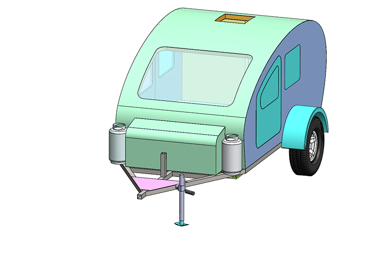

Thanks, Tony. Attached is new design for tank placement. In your photo looks like you're using one of those "PowerTank" propane cylinder holders. I was just looking at them. They look sturdy.
You'll also notice I switched to the swivel jack set up you had mentioned. I like that.
Are you able to share your opinion on the axle distance / placement I had asked about in a previous post or 2 back (this thread). I just want to try and confirm the distance is correct (regarding the 40/60 rule).
Thanks very much.
John

For mine I used a welding tank bracket bolted to the box. The tank sits on top of a drive flange with a 3/4" rubber toilet gasket to act as a buffer. The flange is welded to a square tube that goes into a receiver tube so the whole thing can be removed. I made a similar insert for a 10 litre water tank for occasional use. I tend to use the 2 5 lb. tanks most often though.

We have two of those 5# propane bottles and they go in the tongue box, one on each side.
Totally of of sight for any thief to grab.

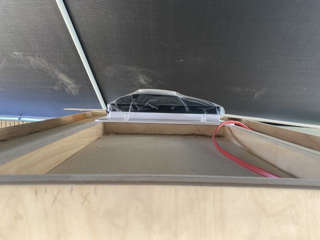

Capebuild wrote:About mounting the Fantastic Fan unit. How does that get mounted on a curved roof when the flange on the fan is flat? any suggestions?
I've located mine at the flattest part of the curve. The header-spars are straight pieces of doubled-up 1x2s. I figure the skin will be slightly squashed around the vent, but not enough to cause any ponding.
Notice the slight curve of the wall vs the straight headers.
Edit: I did, however, curve the bottom edge of the headers to match the ceiling profile.
It looks fine. It should be close to the 60/40 on the trailer frame, not the total length of the trailer. Just make sure you plave the axle using actual stubs, not the torsion axle's cross-member.

anytime you start mounting 'any' fuel tank of any type (whether propane or gasoline) in the tongue area, I would be checking and than adjusting that tongue length to be long enough so as to keep those 'mounted tanks' from "ever" making contact with the tow vehicle in a 'jack-knife' when backing up (thinking ahead). I have seen damage caused by the mounting of one before to the back of a vehicle and it's mounted tank before, same goes for the mounting of that 'oversized tongue box'. I got to 'watch' that happen right in front of me once - the truck/trailer I came up behind him at a camp ground just as he started to back into a camp-spot - when seeing things were going to hit, I 'baled' out of my vehicle, running up trying to let him know he was about to hit the quarter-panel of his PU(new) with the 'big' mounted tongue box but was to late. (and of course, he than was mad at me for not warning him sooner - I walked away wishing I hadn't even tried........) Safety-wise, I think a propane tank mounted there would probably be ok being they are made so HD but it could = future vehicle body damage - it's those plastic 'roto-molded' gas storage units I have been seeing people mounting to the sides of their tongue boxes these last few years that are making me 'cringe' every time I see them - if there is a 'jack-knife' when backing up, I can 'for-see' a fuel leak and/or "fire" incident....... and yes, I do carry a propane tank on my tongue - but it, along with my tongue box are sized & mounted 'with-in' the 'vee-ed' boundary shape of my tongue = with no over hang and when I did my back-up 'boo-boo' awhile back, making just a bit of contact, it ended up being 'just' a touch between my PU bumper and the tongue frame rail............ it does happen..... :roll:
