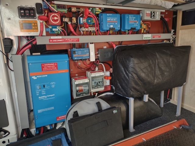

I used 4 pads under my battery and that's been working well for me.
I'm using the same digital thermostat you have shown in the link and I'm happy with it.

Almost forgot; one thing that goes a long way towards lowering how much energy you use heating your batteries is insulation. My wife made a battery cozy out of thinsulate for the batteries and it helps a lot. I take it off in the spring and put it on in the fall.

My batteries are in a van that gets HOT in the summer time. On top of that, batteries get warmer when you charge them. Heat is the biggest accelerant to LiFePO4 degradation. It speeds up the electrolyte decomposition that binds lithium in a non-reversible chemical reactions. The result is less capacity due to Lithium reduction, higher equivalent cell impedance, and greater cell self leakage rate. Above 35C it starts to get bad, above 50C it is very bad. So I take the insulation off when I know I wont be using the heaters, to try and keep the batteries cooler.

I have my sensor clamped to the battery terminal as that seems to have some thermal mass that keeps the temperature from bouncing around like crazy. I have the heat come on at 36F and off at 40F.

I'm using a Victron temperature sensor and the heater relay is controlled by a Victron Cerbo GX. The temperature sensor is all set up to clamp to the battery terminal.
