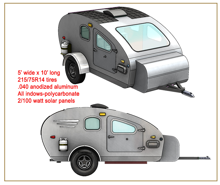

Postby Capebuild » Thu Jun 17, 2021 10:02 am
Interesting thread.
I'm currently building what might be considered a reverse teardrop.
When I was going through the design process I too was concerned about extra drag this shape might cause.
I had my reasons for going with this shape and I figured if it used up a bit more gas in our travels, so be it.
When I get it finished and on the road, that will be the real test; I suppose.
John
