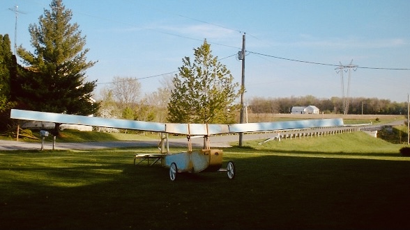

Postby Squigie » Wed Oct 13, 2021 10:36 am
cluttonfred wrote:Maybe we could return this thread to the actual topic at hand…. Does anyone know of any complete plans for foamie truck campers? Coming from a homebuilt aircraft background, I have seen designs like the Sky Pup ultralight that use foam shear webs bonded between wood cap strips to make light, rigid spars. I wonder if the same approach could be used to make a rigid wood and foam frame including a cantilever portion over the cab for a very light truck camper? Cheers, Matthew
Since I have not built a foamie, I have no personal experience with such.
But my problem with the Sky Pup, and similar designs, is that any damage to the wood usually results in catastrophic failure or catastrophic repair. (Basically, 'rebuild that portion/assembly from scratch'.)
When you're looking at a monocoque camper built in such a way, there really are no subassemblies for the structure. You have to scab a repair onto it, or start over.

I hear you, but I was not looking to optimize the structure to quite that degree. Basically I am thinking of using 1x2 lumber and 1-1/2" foam but gluing the wood between the foam to form beams with wood caps and foam webs in the walls of camper, not a monocoque structure at all.
