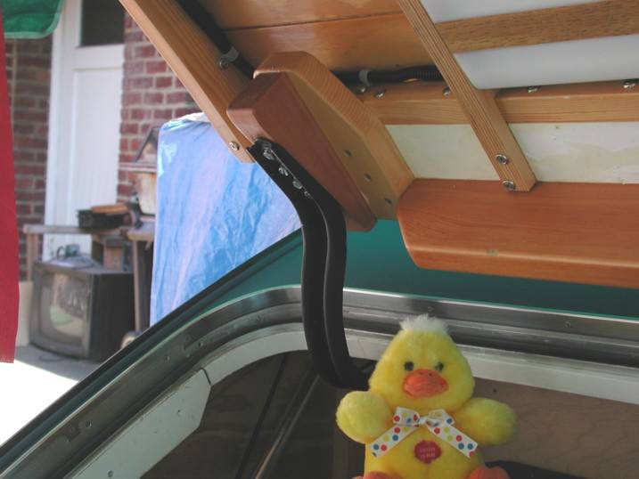

Speaking of hatch hinges. I’ve been considering salvaging a pair of automobile trunk hinges. They are spring loaded and bolt simply to the trunk. Depending on how they are attached to the vehicle you may be able to simply unbolt a pair and bolt them into the structure of the tear. While you’re at it why not attach a strip of aluminum or angle all around the inner hatch cut out and use a length of automotive rubber trunk seal around the perimeter. This would make a very clean waterproof installation and all the parts are available at your local junkyard.

I've seen automobile hinges used before,This is the hatch on Marty Boehme's teardrop.
Automobile Hinge on Teardrop

The auto trunk hinge in the photo is exactly the set up I was suggesting. I will seriously consider this type of hinge on any type Teardrop I might build.
