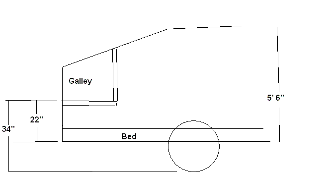

My plan, so far, is a combination of the tailgater and the weekender. The floorplan is similar to the tailgater but on a bit smaller scale. It has a queen bed instead of a king. The general shape is like the weekender. Hope this makes sense.

Postby mikeschn » Sun Aug 22, 2004 5:59 pm
I can see it...
It's 5' wide... 4' high, and 10' long. It has a porta potty in the first 3 feet of the trailer. The "bathroom" is 3' wide and 3' deep, leaving only 2' for you to enter the trailer and dive into bed. BTW, that's a tight squeeze!
The bed goes all the way to the rear end of the trailer, so the only galley would be what ever you can shoe horn in over the bed. I see a very tight fit for the feet.
Am I close?
Postby catrinka » Sun Aug 22, 2004 6:06 pm
I was basing it on a 5 1/2' wide trailer but that could shrink to 5' and we are going to make it 5 1/2' high to allow for standing. And the bathroom is 2' wide (after careful studying while meditating in the bathroom). The galley worked on paper. Did I miss something?

Postby mikeschn » Sun Aug 22, 2004 6:19 pm
Well, I'd have to see your plans... but based on what you are saying I am starting to see something like this... I could be wrong though...
Do you have Paint on your computer? If you do, you can draw or sketch your ideas, and then upload them to your album here...
Here's my sketch...
Postby catrinka » Sun Aug 22, 2004 6:51 pm
I have a rough sketch in my album now. That will have to do until I get a scanner going.

Postby mikeschn » Sun Aug 22, 2004 7:29 pm
That's one long trailer you got there...
I see 7' for the bed, 2' for the porta-pottie, and another 2' for the galley. That's 11' of trailer. Are you sure you want something that long? Especially if it's that high?
5x11 or 5 1/2 x 11 is going to weigh 1500 to 1800 pounds. Can your tow vehicle handle that?
And you're going to build this in the park near your apartments in a weekend?
Just going for the reality check... please bear with me...

If you consider doing your porta-potti like Bev did with that side tent thing, that would cut the length down quite a bit.
