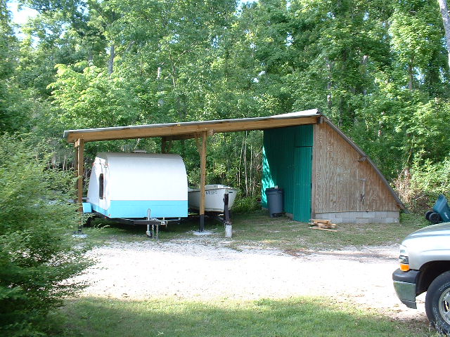

I wracked my little brain over the hoilday trying to think of a simple way of garaging these TTT's .... may be easier to build a simple shed/roof to house them , rather than complicate/compromise a good simple trailer design ...We added a roof to our garden shed to house the big bugout and it made all the difference in protection ...Easy and cheap too ...4"x4" PT posts , 2"x 6" PT rafters ... R panel roof ... Only took a day to build ...EASY ...

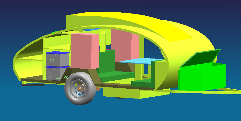

The ET is now has a 69" sidewall, and from the ground to the trailer is about another 11". Plus the channel is 3". So from the grount to the top of the trailer is now 83". that does not fit in my garage. It probably doesn't fit in most 7' garages either (the door is in the way).
But like you said, rather than compromise a good design, I'll run with it, and plan on having a sunbrella cover made for it.
for those who want a garagable design will have to build something different, like the "Something Simple". I've made the "Something Simple" a bit more complex, but then, that's me!!!

Mike , Beauty drawing!!!! A very visually attractive design !!! :)

Here's a pic of my simple shed..... does great for protecting the Big Bugout Image
Postby bobhenry » Fri Jul 06, 2007 7:29 am
Mike
wanta have some fun figure the snow load on this roof with about 2' of heavy wet snow on it !
Did I hear a CRACK ! :D
