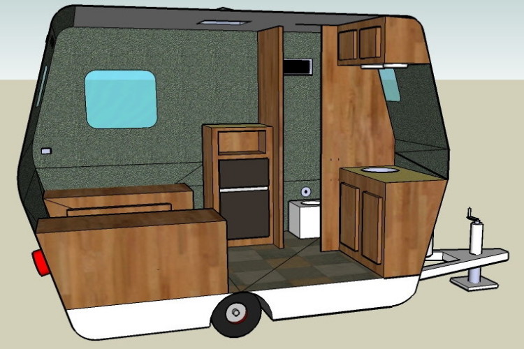

I was thinking along those same lines using a 4'x8' trailer hanging a foot over on each side (like Puffin) to make it 6' wide and then curving each end out 1' to make it 10' long in the middle of usable space. Maybe somebody has already explored this, I dunno? While its not as pleasing to the eye as a canned ham shape I dont think its thaaat bad. Here's my rough sketchup draft I know it is full of mistakes I am still trying to get the hang of it but you get the idea.

Postby mikeschn » Fri Sep 12, 2008 10:45 am
Hmmm... that seems like a really small bed you have in there. It's about 72" long. I can't tell how wide it is...?
The other thing I don't like is how far inboard the wheels are. I like my wheels flush with the outside of the body. More stable around curves and all that good stuff.
And the only person I know who has made a 4x8 trailer wider, is Arne.
It looks attractive otherwise. How high is the sidewall?
Postby StilesMA » Sat Sep 13, 2008 10:56 am
Mike,
The side wall is roughly 7' and only 6' of standing room. I would not be widening the trailer frame but building out over the wheel wells making the camper body 6' wide. So I was thinking of having a bed roughly the same as the puffin a bed only 6' x 4' roughly. The wheels are not to scale
I haven't really gotten the hang of using sketchup yet. I have already gotten a trailer and measuring from the outside of the tire to the other it is five foot wide ( the inside frame is only 4') so i guess i would only have 6" hanging over each wheel. Thanks for the complement and critique .

Postby Miriam C. » Wed Sep 17, 2008 9:45 pm
StilesMA wrote:Mike,
BTW I am also working on one that looks like a tiny Spartan Manor I'll put it my album.
You should be able to get a full bed out of the space, or real close. Then package the wheels so you won't be too heavy in the back.
I have mine pushed out with curves but the bed only needs the top pushed out to work. I ended up with about 9 useable inches for the bed. Makes a big difference in floor space.
