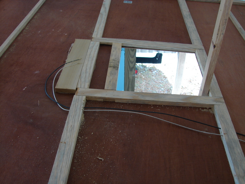

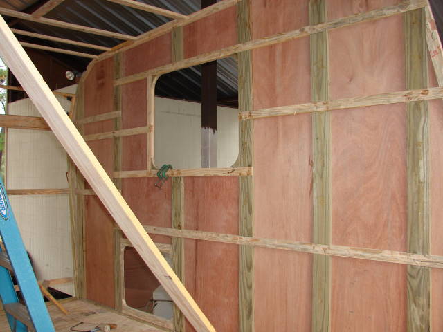

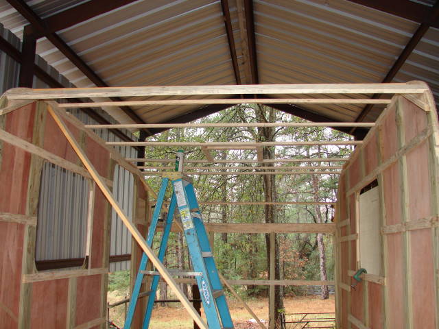

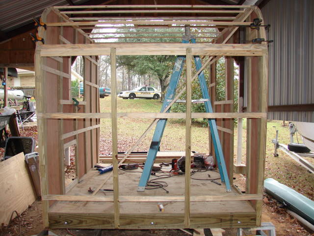

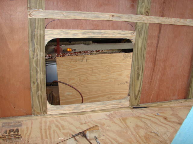

We sqaured up the side walls, installed some spars, Completed the rear wall framing, and cut out the windows and hatch. We will start framing in the front slide out opening and then install the ceiling. All of the joints we are doing are dadoed lap joints. It is amazing how strong everything gets once you start tying it all together. Here are some pics of the Progress
Some spars installed and roff vent framed in
Rear wall framed in
Hatch cut out
Windows cut out

Is that green wood poplar or pressure treated?

bdosborn wrote:Is that green wood poplar or pressure treated?
And why are the police at your house?? Trailer building illegal where you live??? :lol: :lol:

Postby dploch » Thu Dec 13, 2007 1:14 pm
Pressure treated........and I've read all the threads on the dangers
As far as the Police car.....did I mention I'm a Police Officer.....been one for 22 years.

Postby dploch » Thu Dec 13, 2007 2:18 pm
To follow up on my earlier statement....The treated wood of today is not the same as the Arsenic treated wood of the past. This wood is ACQ treated and not a danger to be used indoors. For this reason I am using it for the sill on my floor and for parts of my frame. I will be using untreated wood on my walls, floors, cabinets, etc.

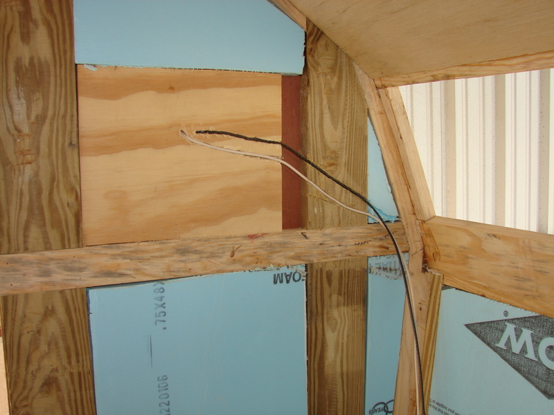

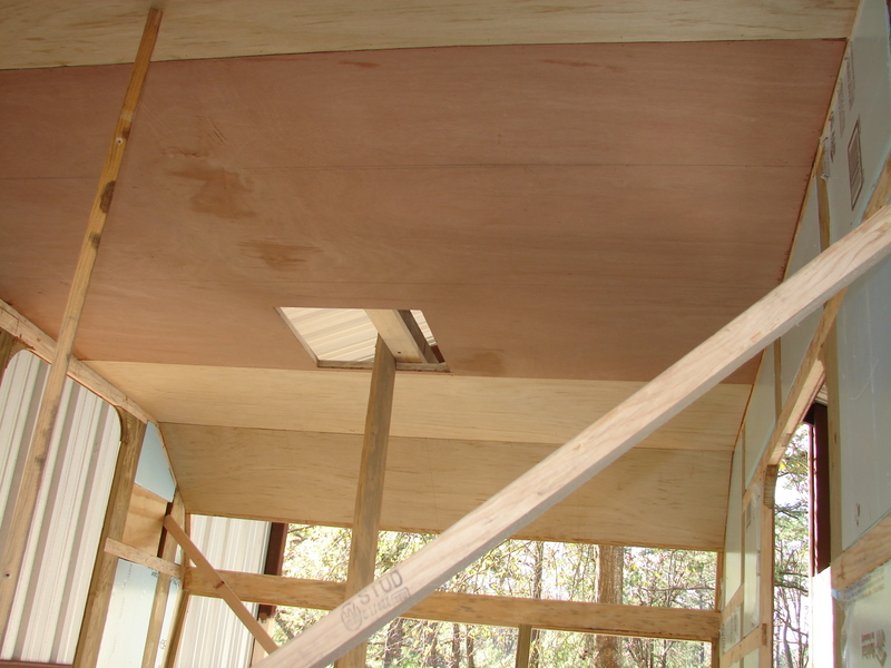

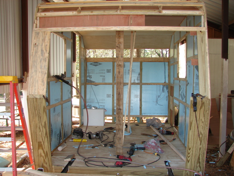

Well me and my dad have done more work on the trailer. Here are the latest pics.
Roof Insulation and wiring
Interior walls insulated
Ceiling put in
I can't begin to count how many times we have climbed a ladder or crawled onto the trailer back and forth to get a saw, tool, etc. It seem like whatever you need is never close. We will take off a couple of days and celebrate Christmas. Hope you and yours have a wonderful Christmas and a Happy New Year.
