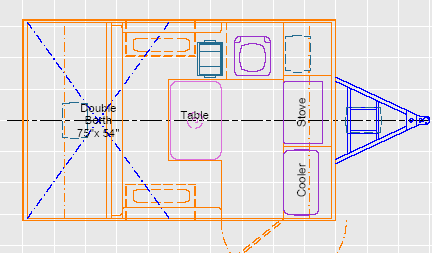

Okay, I am just trying to get a feel for the size, and what you guys would like to see in this design.
Here's a quickie... what do you think about the floor plan? The bunk? the porta potty room?

Postby aggie79 » Mon Jul 07, 2008 5:40 pm
I don't know how light (or heavy) it is or what the dimensions are, but the standie shown in the link below (second one from the right) has a transverse bed and a shower with potty:

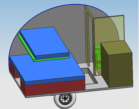

Here are some more thoughts... since it's a slouchie right now... 62" roughly, I tried a couple 6" dropped floors.
Any more thoughts?

Postby mikeschn » Mon Jul 07, 2008 7:02 pm
I just tried making the wall a little taller. I must have gotten carried away. It's 89" tall now... :duh: :hammerhead:
But you can look at it anyways!!!

Your plan is coming along. 9' long is really the right cabin size. I built our 1100GE with an 8' long box (mostly to prove to myself that I could), but it was tricky to work in the door ahead of the wheel. I had to notch it like the rear door on a car to make it work.
You might try bringing your bath up to the bed. The aisle does not have to go all the way across. Face the bath door toward the centerline of the trailer. The area in front of the trailer (just inside the door) can now be a shower, or at least a dressing space. Plus, you can close the bath door and still have room for your knees...
If you use a short profile toilet, you can elevate the floor under it (tank?) and move it forward for more floor area.

Postby mikeschn » Mon Jul 07, 2008 7:24 pm
Eric,
It is possible to edit your thread. See that edit button at the upper right hand corner of the message! :D
Anyways, I thought about bringing the bathroom wall all the way to the bed, as you can see in this picture... but then it would be difficult to set up a dinette for 4 in there. The table would end up being much smaller so that a person can slide in past the bathroom wall.
