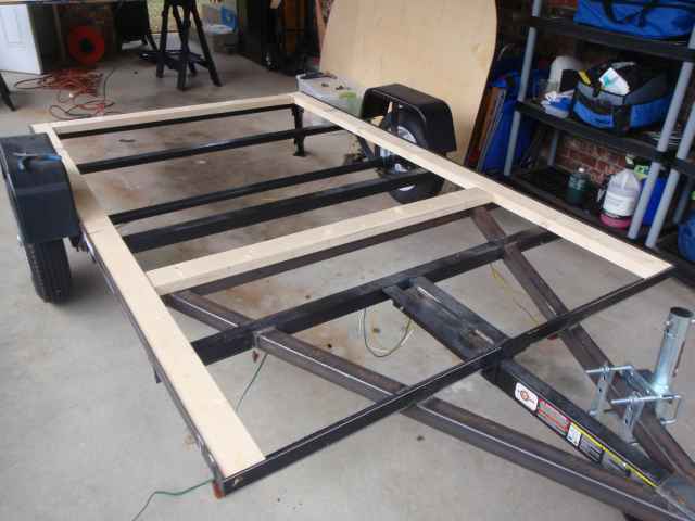

so I started framing for the floor:

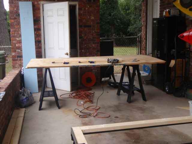

A look at my work area:
Who in the world cut that!! :roll:

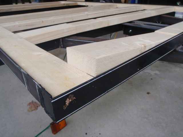

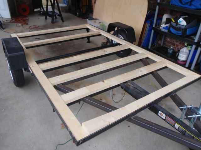

A good look at how the frame will be:
I swear...this cutting thing takes a little getting used to, but this aint nothing a little rubber mallet can't handle!! :hammer:

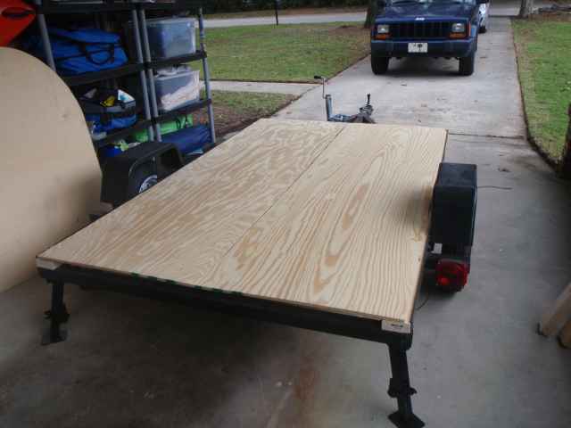

A little wishful thinking of a look at the floor:

Hi Mandy, I think the concern of the wood sitting on the frame is valid, but I was thinking you don't need much to create airflow which equals evaporation. How about some washers on the vertical bolts between the wood and frame. This may or may not be a good idea depending on how level the trailer will be as it may cause pooling too, but I'm "stewin" on this greatly as well. Isn't it nice so many strangers are thinking about your trailer too? :lol:
It might actually be as simple as sealing the 2x4's with epoxy before laying them down for the last time and then using the roof tar stuff to seal the joint between the wood and metal too underneath. :thinking:

How about some washers on the vertical bolts between the wood and frame. This may or may not be a good idea depending on how level the trailer will be as it may cause pooling too, but I'm "stewin" on this greatly as well. Isn't it nice so many strangers are thinking about your trailer too? Laughing
It might actually be as simple as sealing the 2x4's with epoxy before laying them down for the last time and then using the roof tar stuff to seal the joint between the wood and metal too underneath. Thinking
Thomas, isnt funny you should mention that cause I have plans to actually put washers under the framing to leave somewhat of a gap. but i am also sealing all of my wood with cpes before i do the bolting down. just the framing will be in the angle iron, the floor and wall will be above it. i am covering the bottom with the black goo as well. sooo...hopefully all of this will keep the rot away!!

As well as washers under the wood, you might consider making the wood framing just a bit smaller than the frame inside (1/8" or so all the way around) and that would also keep water from being trapped around the sides. Your vertical bolts will then hold it in place (or you could put some shims around the outside too.

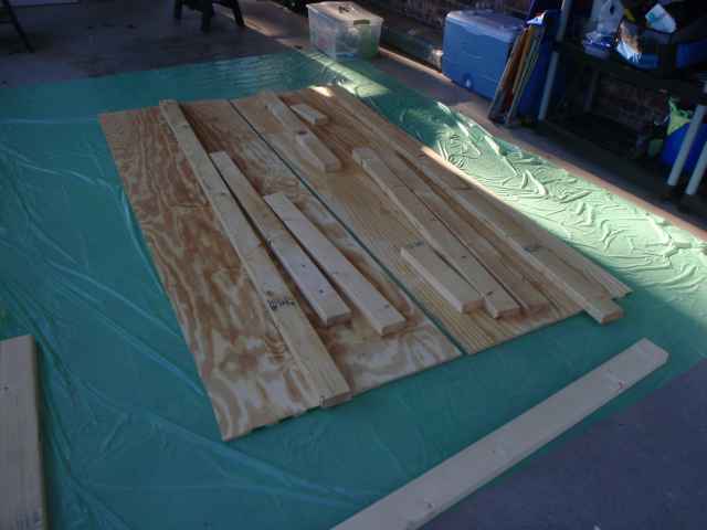

Postby S. Heisley » Mon Oct 20, 2008 3:33 pm
I'm glad you're using CPES, Mandy. Please remember to also coat the places where you drill holes to attach it to the frame. Edges of the wood and drilled holes are the most vulnerable. Whenever you need just a little CPES, you can mix it in a clean, dry margarine tub. If you need to take a break for lunch or something, pop the margarine tub lid on and it will slow down the congealing of the mixture. It will also keep the fumes at bay somewhat. One coat of CPES makes the wood water resistant; but, supposedly, 3 coats of it will make the wood waterproof. If you were to use 3 coats, you wouldn't need the black tar stuff. During the rainy season, diesel fuel from the road can splash up underneath and liquefy the tar stuff.
When you get ready to drill the holes to attach the wood to the metal and have the CPES'd wood clamped to the metal, remember not to push down on the drill. Let the drill do the work slowly, using the slowest speed. Assist your drill by using only enough pressure to keep the drill where you want it, no more than that. It will take longer this way but will help your drill stay cooler and keep your drill bits sharper longer. I suggest this because people assume we already know to do this; so, sometimes don't mention it for fear of insulting us. (I had to learn this from a book.) I think you know I mean well.

Postby rhltechie » Mon Oct 20, 2008 4:27 pm
Thanks for the comments all. I had taken today off a while back for a reason i cant even remember, but i used it on the TD but I feel like today was a waste...i started at 10, ended at 3:30 ish and all i got done was to get cpes on all of the subframe and flooring. I did make a trip to lowes for the new drill. I have to say, the corded one I got made it through the steel without even flinching. I will use it instead for tough jobs on the TD. It just seems like one could have gotten more done in the span of 5 hours. I know, I know...it takes time..be patient. I just like to see progres! This was basically all I got to see today:
I think this was the highlight of my day:
I did also get the profile I made, out and do some drawing on it. I think it was too late in the day for my head to make sense of much because all of the drawings I did made no sense at the end. I kept looking at the benroy plans going...hmm..ok, yeah..thats not right. but then i have to keep reminding myself these were just a really good start. I think I will have to come up with a lot of the rest on my own! :worship:
also...along with not feeling like I did much, I am exhausted!! :lol: Now how much sense does that make!
Oh well, the cpes should be all soaked in soon and I will be able to put the floor down. I was hoping to be done with the floor this weekend but as I stated in a previous post the first thing I learned when i started my first day of TD building is that something you think will take an hour..usually ends up taking 3 if you are lucky...4-5 if you are having an off day :)
