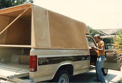

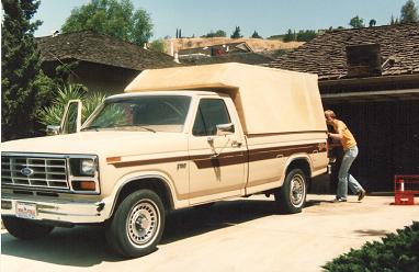

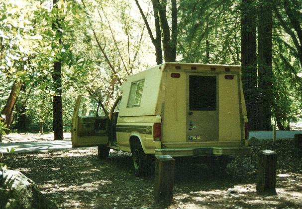

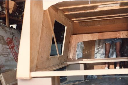

Postby Wolfgang92025 » Thu Oct 01, 2009 10:05 pm
I build the camper below in the mid 80's.
Used 3/4" Poly Iso insulation panels.
That was all I could find, way before internet.
Had to peel of the aluminum cover from both sides. :(
From what I remember, it was a real pain.
Used 3/4" pine furring strips were I needed to attach things like lights, windows etc..
Had to scan the pic's to upload.
Whole thing weighed maybe 80 lbs. Could lift it by myself, but it was very awkward being so large. Did not know about CEPS. After about 10 years some of the wood started to rot. Getting a half way good finish took a lot of work. Maybe that's why I don't care a lot for fiberglass.
Wolfgang
