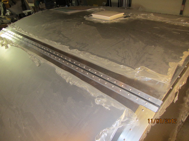

Postby Irmo Atomics » Thu Nov 01, 2012 4:50 am

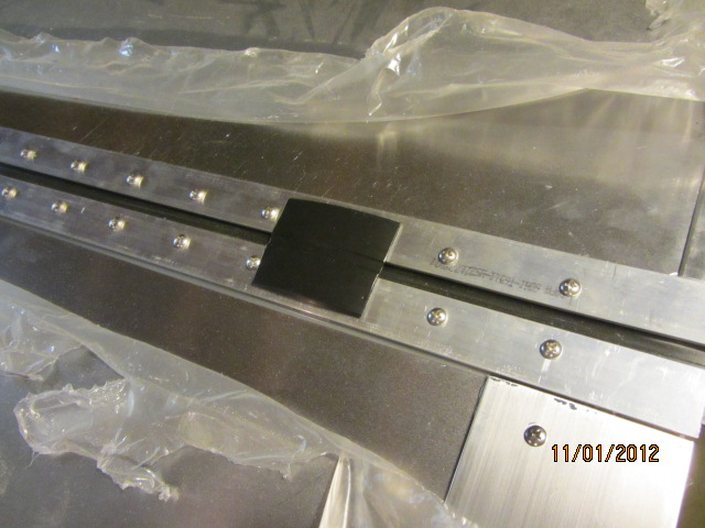

I used Monroe "living hinge" 2" wide
Here's a shot with a piece laying on top for reference

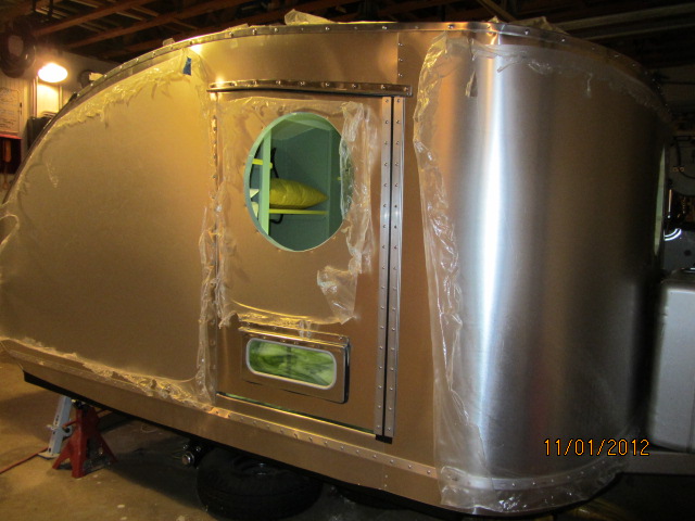

And since I had to get 50 feet of it, I used it for the doors, too.They aren't finished and they look like they got a sunburn and are peeling, I haven't pulled all the plastic off the aluminum yet... next week!
Here's a link to Monroe: http://catalog.monroeengineering.com/vi ... c=100|1758
