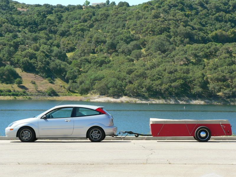

There are a lot of cool combinations posted in this thread! :thumbsup:
Brakes! People! Brakes! Good, fresh brake pads and fresh brake fluid will help to keep your brakes' temperatures out of the brake "fade" zone longer on your downhill descents. Have your brake fluid replaced at LEAST every two years.
My tow vehicle is a 2003 Ford Focus PZEV* ZX3, equipped with a 2.3-litre four cyl. that has, with mild engine and exhaust airflow modifications, 155 lb/ft torque (and 155 HP). The car has a curb weight of 2710 lbs.
*Partial Zero Emissions Vehicle
I have fitted the car w/ a Ford Focus factory SVT/ST170 (UK) big brakes kit. I plan to fit electric brakes to my half-teardrop wagon (it is to become a full teardrop). It is unbraked at this point and weighs, fully-loaded, 850 lbs.
Before the extra 300 cc's in engine displacement and before the big brakes, the car had a factory tow capacity rating of 1200 lbs. I wish to keep the finished teardrop loaded weight to no more than 1100 lbs and fit the trailer axle w/ 10" electric brakes. Trailer wheels are 16 X 7, same as what's on the car, and the trailer's tires are also the same size as what's on the car: 205/50-16.
When not towing, I can never break the 30 MPG barrier... The car's engine is a bigger, torquey, thirsty four-cyl saddled w/ the largest exhaust catalyst known to man. When not towing I cruise at 70 - 75+ w/ the air conditioning on: 29.95 MPG is my best to date in 8 yrs.
With the trailer, now, I cruise at 60 MPH (5 mph over the posted legal limit in CA of 55 mph) at get 25.50 MPG.
The trailer tows with an extremely stable attitude and when loading it I strive to acheive between 50 and 75 lbs trailer tongue weight; no more, as it is a front-wheel-drive vehicle and I wish to keep the front axle planted. This is how the europeans tow, with very little tongue weight.
Before whomever wants to starts crying about trailer sway due to no tongue weight: you're barking up the wrong tree! Load your trailer wisely, use good tires and inflate them properly.
I now have over 1700 miles towing with this combination.

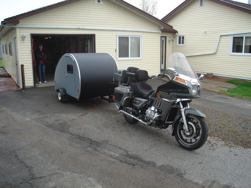

I tow my lightweight TD (300lbs) with my 1983 Honda Goldwing. It's 1100cc and runs about 80hp with 65ft/lbs of torque. The trailer is still a work in progress, but I towed it home from my Dad's house over 300km without any major issues.
Headwinds and hills do tend to make the bike work hard, and my fuel mileage went from about 43mpg to around 32mpg. More distance for braking is also a given. I'm looking to upgrade to a newer 6 cylinder Goldwing in the next year or two.
